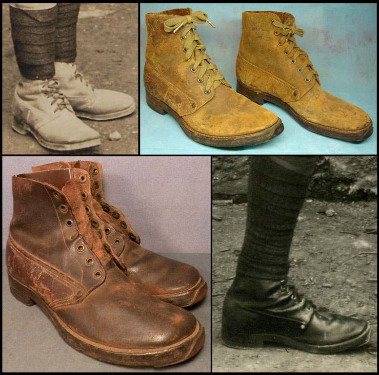

1918 Field Shoe, Specification No. 1309
Model “A”
Adopted on March 2, 1918
The 1918 Field Shoe was described thusly in the post war book titled, The Army Behind the Army:
The so called “Pershing shoe” … really should have been classified as tanks instead of shoes, for they could go anywhere, they could withstand any amount of use or abuse, and they were, literally speaking armored. The “Pershing shoe” has three outer soles which are fastened to an inner sole of outer-sole quality and thickness, first by nailing, then by screws, and finally by stitching with heavy linen thread; the toe is reinforced with a molded steel plate; both sole and heel bristle with hobnails, and as a final touch, the heel has a heavy steel horseshoe around its edge. It was by long odds the best shoe worn by any army.
The Army Behind the Army, Edward Alexander Powell, 1919, page 180

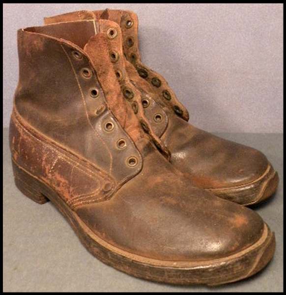

Photo No. 136: A closer view of an unissued pair of Pershing Shoes. Note the heavy triple leather sole, the steel toe plate, and the thicker steel heel plate. One of the thousands of Doughboys who actually wore the Pershing Field Shoe had this to say about his ungainly iron studded footwear:
Got the full equipment today. I have some of the cutest little hobnail shoes with light soles ¾ inch thick and 3 kegs of nails in the soles of each. I have shined them up until they look like patent leather.
Sergeant Charles L. Johnson, 10th Infantry Division
world war I nerd

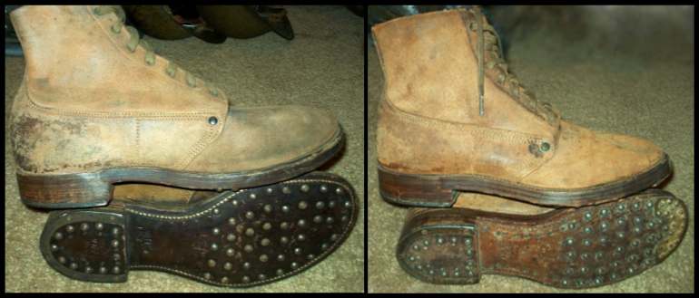

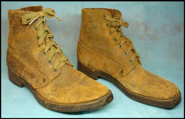

Photo No. 137: While the 1917 Trench Shoe (left) and the 1918 Pershing Shoe (right) share many common attributes, the difference between the uppers and soles of the two shoes can be seen in this side by side comparison. The most obvious being the steel toe plate toe plate and the thicker sole on the Pershing Shoe.
Photos courtesy of the Kration collection
world war I nerd

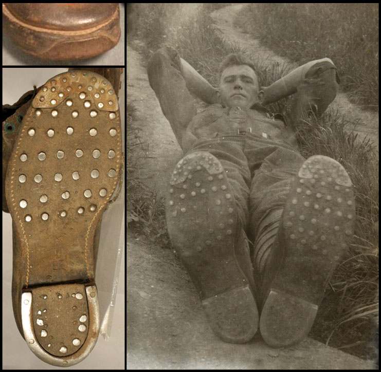

The primary characteristics of the 1918 Field Shoe, Specification No. 1309 are as follows:
  • The Pershing Shoe did away with the welt as the 7-iron inner sole of outer sole quality was not sewn onto the cowhide upper. It was instead clinch nailed using lasting tacks.
  • The 8-iron top sole, 8-iron middle sole, and 10-iron outer sole were sewn together with 9-cord, waxed linen thread.
  • All four soles: inner, top, middle and outer were then clinch nailed using No. 10 nails and screwed or “metallically fastened” by means of brass standard screw wire.
  • The bottom filler was once again comprised of ground cork and cement.
  • The forepart of the outer sole was studded with round, oval headed hobnails. However, a new pattern was adopted to allow room for the toe plate.
  • A case hardened steel toe plate, which projected ½ inch over the front of the sole was screwed onto the bottom of the shoe.
  • A heavier steel horseshoe shaped plate that was 3/16th of an inch thick and 3/8th of an inch wide replaced the thinner 1/8th inch thick steel heel plate that was used on previous specifications.
  • One row of hobnails was added inside the horseshoe shaped steel plate to protect the inner heel from wear.
  • The shoe was constructed from vegetable tanned, natural colored cowhide or kip, “heavily stuffed with “pure greases”, with the rough side of the leather turned out.
  • The thickness of the leather at the vamp was to be no less than 2.5 millimeters and not more than 3 millimeters in thickness.
  • Each component of the shoe’s upper was to be cut only from what was called the “bend” portion of the cowhide.
  • A new “counter” pattern was designed for this shoe. However, counters cut on the same patterns that were used on the Specification No’s 1269 and 1271 shoes were also used on this shoe.

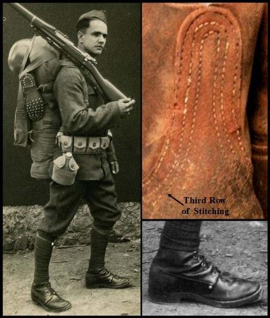

  • The back of the heel counters were sewed to the upper using three rows of stitching.
  • The stitching on each side of the heel counter was vertical.
  • A 5/16th inch diameter japanned steel rivet was used to strengthen the front corner of each blucher ear.
  • All sizes of the shoe had seven rows of brass lacing eyelets.
  • The shoe was unlined.
  • Each shoe was ink stamped on the inner side of the quarter with the contractor, contract date, specification number, and depot.
  • The shoe’s size and width was also permanently die cut into the top of the quarter using a steel cutting stamp with the model “A” to follow the size.
  • Each shoe’s size and width was also stamped into the shank area of the outer sole near the heel.
  • Each shoe’s upper was waterproofed during the manufacturing process with a waterproofing solution known as “dubbing”. In addition, a “liberal supply” of that solution was applied to the seam where the vamp and the sole were joined.
  • Each shoe weighed approximately 2 pounds, 12 ounces.
  • Each shoe was approximately 7 inches high from the bottom of the heel.
  • The shoe was manufactured in 15 lengths running from 5 to 15 by half sizes. No half size was available for size number 15. Each length was available in six commercial widths (B, C, D, E, EE & F), making a total of 90 available sizes.*

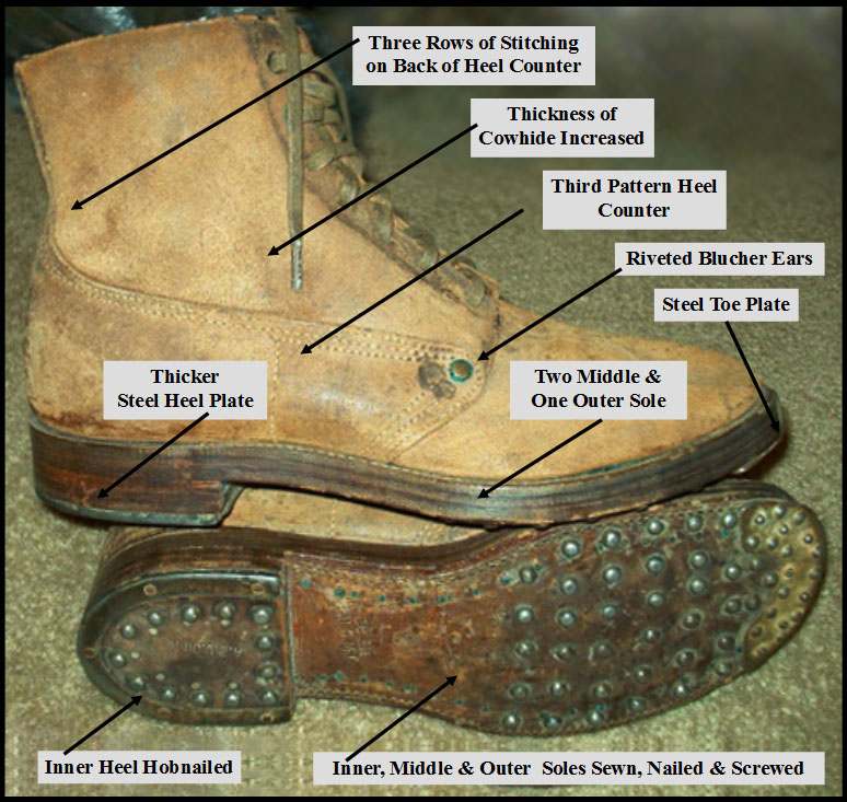

The external traits that identify the 1918 Pershing Shoes are pointed out on this pair of unused 1918 Metallic Fastened Field Shoes.

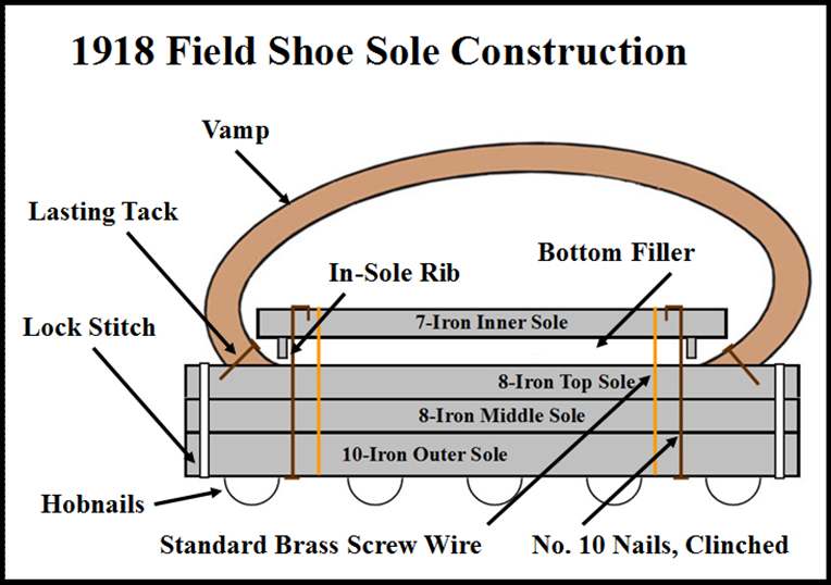

Photo No. 139: The configuration of the 1918 Pershing Shoe’s sole is shown in this diagram. The increased thickness of the shoe’s sole combined with the brass screw fasteners made the shoe’s sole extremely rigid, and therefore unsuitable for mobile troops. However, the fact that trench warfare in general, required far less mobility, the heavy Pershing Shoe was adopted despite it unsuitability for marching.

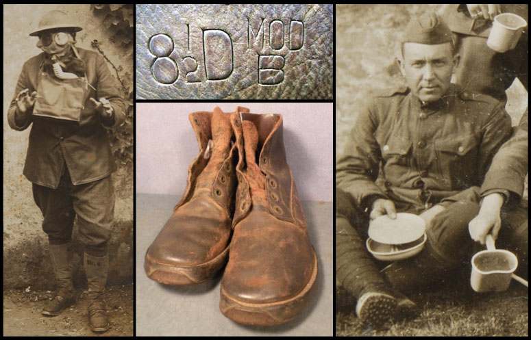

On the same day that Model ‘A’, Specification No. 1309 was adopted, Model ‘B’, Specification No. 1310 was also adopted on March 2, 1918. Aside from knowing the specification number along with the date that it was adopted, I have no additional information explaining how the Model ‘B’ Pershing Shoe differed from the Model ‘A’ Pershing Shoe.
If any forum member owns a pair of Pershing Field Shoes that are stamped either “Mod A” or “Mod B” next to the die cut size marking on the inside of the quarter, can you please post photos of the side, back, and bottom of the shoe along with a close up of the die cut stamp? If we can get both the Model ‘A’ & ‘B’ we might be able to work out what the differences between the two specifications are.
Photo No. 145: Two photos of soldiers wearing the 1918 Pershing Field Shoe “bookend” a pair Pershing Shoe’s with factory applied dubbin, and an example of the “MOD B” die cut stamp that appears next to the shoe’s size and width on the inside of the quarter. Presumably the Model ‘A’ was stamped in a similar fashion.

The Doughboy’s pack when carrying a rolled overcoat and extra shoes was known as “heavy marching order”. Two examples of that and a display of its contents are shown here.
Upper left hand photo courtesy of the Portraits of War collection
