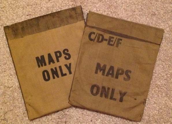

dustin Posted March 2, 2014 #4 Posted March 2, 2014 The pouches marked MAPS ONLY did not exist unit 1945 and only representative in that year. The purses used in 1943 and 1944 like you asked were color coded purses available in many colors for regions/countries containing currency for said regions/countries. If you want to represent the 1943-1944 time frame you need a colored regional map purse. The MAPS ONLY purses no longer carried currency since by that time most of Europe was back in the hands of the allies and no longer really required the capabilities to "buy" your way to friendly lines. "K-rations, candy bars and whatever" is purely personal preference, bringing snacks/meals on long missions were common practice and not intended really as a "survival" ration. The maps you speak of are correct for the era and again just not the waterproof pouch marked MAPS ONLY, however maps were distributed individually as well and carried in the pocket or wherever.
dustin Posted March 2, 2014 #5 Posted March 2, 2014 there is about 25 variations of the map purses but only about three of those are actually marked MAPS ONLY. Most are marked with color codes and letters , capitol F=France I=Italy etc. This then lends the question , was the mission in/over/near France? Italy? Belgium etc. so you get down to the specific mission even. Some topics get complicated all by themselves.
dustin Posted March 2, 2014 #6 Posted March 2, 2014 You just used the wrong description for an encompassing general description . These purses are 1945-

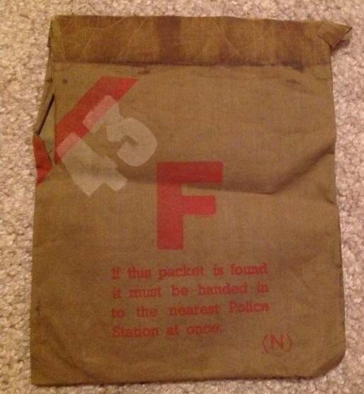

dustin Posted March 2, 2014 #7 Posted March 2, 2014 This is the type of purse you would need for 1943-1944. This purse is the most common France , note color reserved for France other colors for other countries include white, mauve, green, black and yellow to name most.
Johan Willaert Posted March 2, 2014 #8 Posted March 2, 2014 Rick, the details of these pouches are described in the new USAAF Flight Gear book by Bianchi
SeaDog30 Posted March 2, 2014 Author #9 Posted March 2, 2014 Thanks for the photos and the description, it helped a lot! I like the 43 F model!!!
