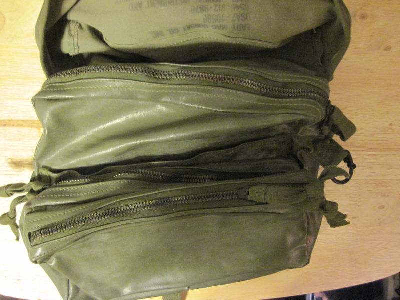

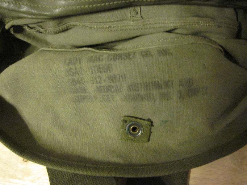

Justin Posted February 15, 2011 #1 Posted February 15, 2011 Hi, can someone tell me about the stamping on this rubberized m3 medic bag? This is the first time I've seen one with this stamping on the inside flap. :think: all the rubberized ones I've seen and own are dated 1968 but I've never before seen one with this type of stamping. It's just a DSA, really hard to make out, could it be a pre 68, 67 era rubberized bag?

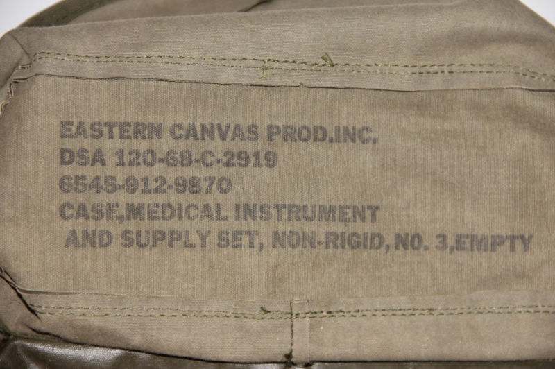

Justin Posted February 15, 2011 Author #4 Posted February 15, 2011 and here's the only type (Until now) stamping I've seen on the clearly marked 1968 dated rubberized bags:
sgtmonroe Posted February 15, 2011 #5 Posted February 15, 2011 Are you are inquiring about the "contract number"? In the post, detailing the evolution of "contract numbers", I did not get into specifics concerning class codes. For example: in a PII of "DSA 100-67-9999" the "100" is the class code which indicates clothing [including individual equipment]. On the FY1968 contracted bag [that you posted] the "120" class code indicates first aid items [DSA 120-68-C-2919]. During FY1965 [01 July 1964 through 30 June 1965] the "contract number" is typically "DSA-1-9999" [there are five digit contract numbers, FY1965 is one of the few fiscal years that this occured]. The "1" in the sequence is the class code and during FY1965 "1" indicates clothing [including individual equipment] whereas "2" indicates first aid items. The single-digit class code was added during FY1962 when the DSA took over and tried to simplify the "contract number" system. Of course during FY1966 the class code is changed to the familar 100, 120, etc. So your bag is a FY1965 contract [DSA-2-10596]. There are many other class codes. I used to have a list of them but for some reason I cannot locate it.
Justin Posted February 15, 2011 Author #6 Posted February 15, 2011 Are you are inquiring about the "contract number"? In the post, detailing the evolution of "contract numbers", I did not get into specifics concerning class codes. For example: in a PII of "DSA 100-67-9999" the "100" is the class code which indicates clothing [including individual equipment]. On the FY1968 contracted bag [that you posted] the "120" class code indicates first aid items [DSA 120-68-C-2919]. During FY1965 [01 July 1964 through 30 June 1965] the "contract number" is typically "DSA-1-9999" [there are five digit contract numbers, FY1965 is one of the few fiscal years that this occured]. The "1" in the sequence is the class code and during FY1965 "1" indicates clothing [including individual equipment] whereas "2" indicates first aid items. The single-digit class code was added during FY1962 when the DSA took over and tried to simplify the "contract number" system. Of course during FY1966 the class code is changed to the familar 100, 120, etc. So your bag is a FY1965 contract [DSA-2-10596]. There are many other class codes. I used to have a list of them but for some reason I cannot locate it. Thank you! :thumbsup:
pwmiraldi1967 Posted February 16, 2011 #7 Posted February 16, 2011 Hi, can someone tell me about the stamping on this rubberized m3 medic bag? This is the first time I've seen one with this stamping on the inside flap. :think: all the rubberized ones I've seen and own are dated 1968 but I've never before seen one with this type of stamping. It's just a DSA, really hard to make out, could it be a pre 68, 67 era rubberized bag? Hey Justin, what Ive found over the years anything without a date, say DSA-100- is always 1967 dated, but like I always say, "No date is the correct date" lol, but yea its 1967-68 era bag
