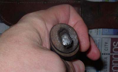

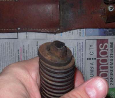

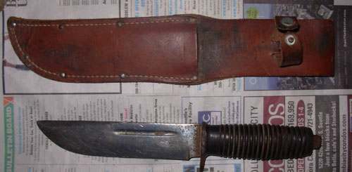

Flash Boredom Posted October 23, 2010 #1 Posted October 23, 2010 Hello Gentlemen, I acquired this knife as a young boy in the early 70's, probably at my favorite hangout(surplus store). I've emailed the Case company on repairing/replacing the pommel but all I got back was a disappointing form email stating that they can't help me. Anyone have any suggestions on how I may find a replacement pommel and/or repair shop? There is obvious(and very cool) wear on the leather-ring handle. You can even see where the user's wedding ring wore-down the leather. It's seen some use!

doyler Posted October 24, 2010 #5 Posted October 24, 2010 You will need a piece that has a more oval design for this knife or have to shape the handle to fit a round style RD
elbertson Posted October 24, 2010 #6 Posted October 24, 2010 It could be taken down on the sides with a belt grinder a bit...diameter on examples I have looks good. Or leave it round for that Seabees look
Coffeecup Posted October 25, 2010 #7 Posted October 25, 2010 Had to find both my Case Q-knife AND my calipers at the same time! The original pommel was appx 1/2" thick, 1.34" parallel to the blade, and 1.1" perpendicular to the blade. Normally you can use the top washer to get the dimension and shape, but it looks like you are missing a few. On my sample, the largest washer is approximately the same size and shape as the pommel. It looks like the tang on your knife is slightly shortened, then peened. This would make it a royal pain in the posterior to restore, and this knife like mine is one with the more common "CASE XX" marking. Personally, I'd go with one of the other suggestions here--use a MKII pommel, or put one together from a piece of flat stock, like on the Western SeaBee. Good luck! Jim

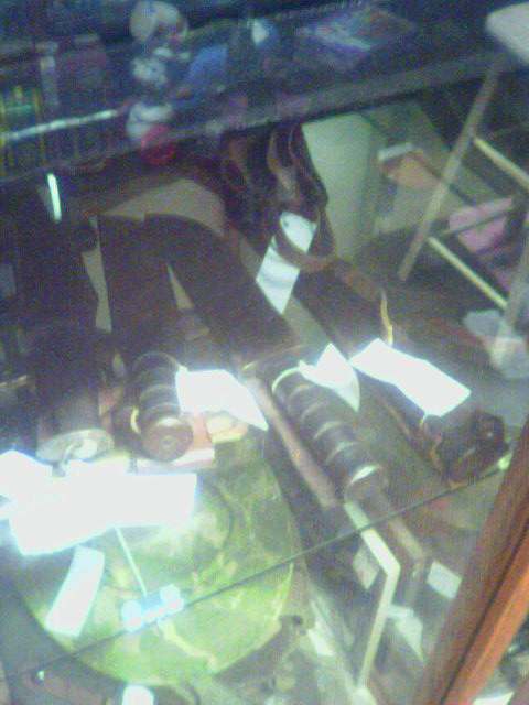

Flash Boredom Posted March 19, 2011 Author #10 Posted March 19, 2011 I never posted pics of all the knives I'd found because my cell phone pics turned-so horrible. You can barely make-out the knives... I'm posting this as a lesson to myself... I waited too long. I went back to find that someone had bought the Case Q that I needed and another sweet Kabar that I wanted(very under priced). "You snooze, you lose" Let that be a lesson to me. [sigh] Note: the Case knife is not in this pic. It was on the shelf under these. I think these are Kabars marked USMC, and another one I can't remember.
