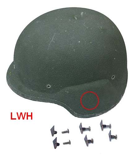

External, there's only 1 difference between PASGT and LWH ;
The big difference is these two screws that are present in PASGT to attach the chin strap.

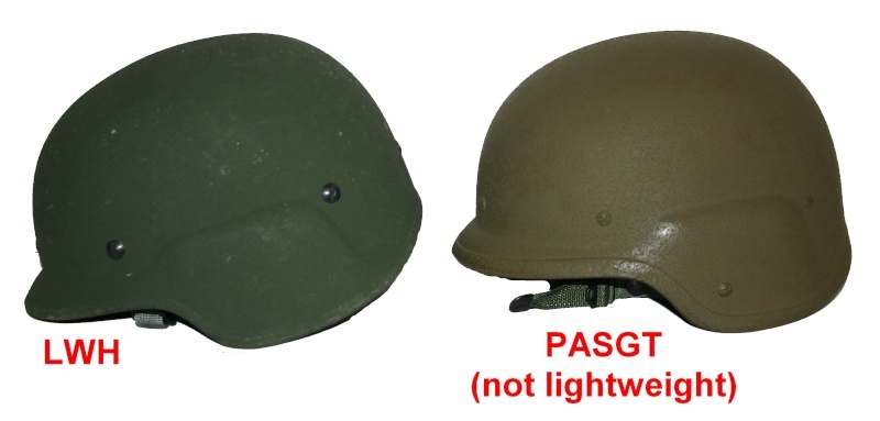

On this picture, you can see an original LWH (left) and an original PASGT (right). We can easy recognize the screw for chin strap on PASGT Helmet and there's also a difference of color of paints for both model.

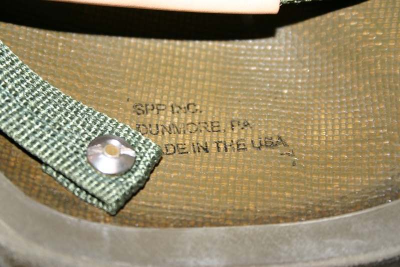

Second label inside Lightweight PASGT helmet ;
You can read ;
"SPP inc
Dunmore, PA
Made in the USA"

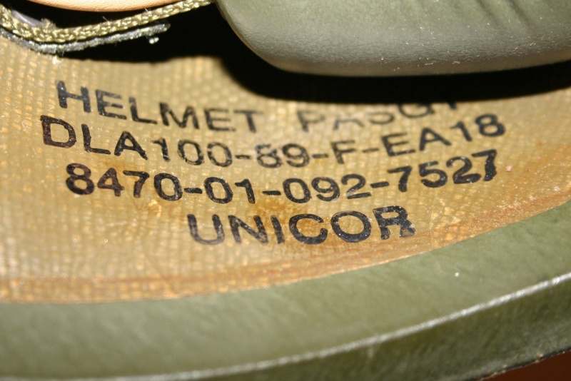

Here's the label of the normal PASGT Helmet ;

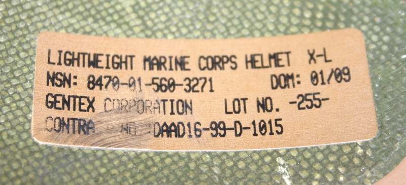

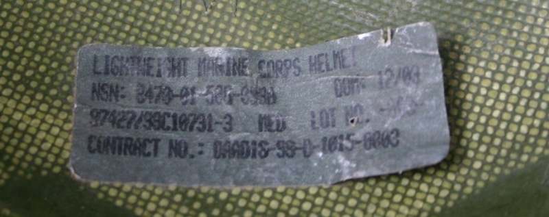

And here're the labels for LWH (OD first and second Tan) ;

So I resume ; for EXTERNAL (so helmet shell - NOT inside)
The only difference between PASGT and LWH is the screw. It permit to easy recognize it.
The color is a wrong indicator to differenciate PASGT and LWH.
