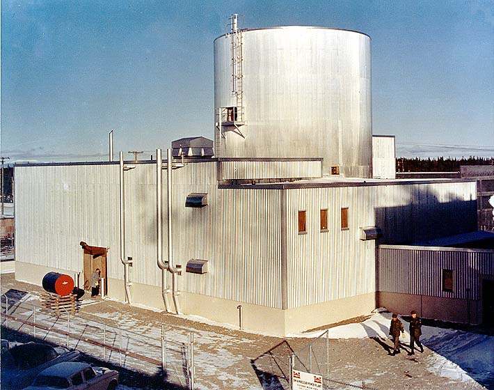

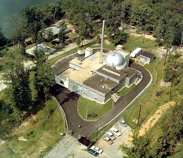

DMD Posted March 6, 2009 Author #3 Posted March 6, 2009 SM-1 (1957 – 1973) was the Army's prototype nuclear plant, located at Fort Belvoir, VA. It served as the training facility and trained about 800 people, mostly Army but some Navy and Air Force personnel also. It had an electrical output of 2 Megawatts and achieved first criticality (reactor startup) in 1957. It was the first US nuclear power plant to be connected to an electrical grid and was shut down in 1973. The Shippingport plant in Pennsylvania was the first civilian nuclear plant to be on the grid, not long after SM-1 did.

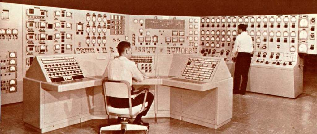

DMD Posted March 6, 2009 Author #4 Posted March 6, 2009 Here is an old photo showing the SM-1 control room.

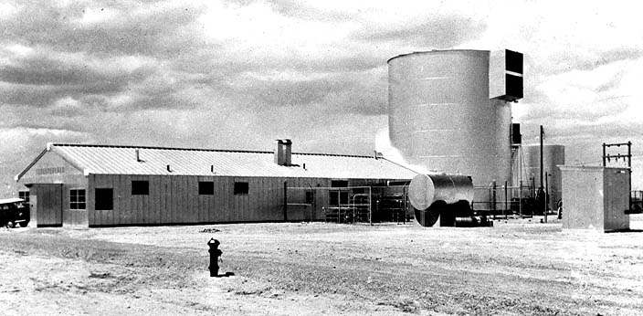

DMD Posted March 6, 2009 Author #5 Posted March 6, 2009 SL-1 (1958 – 1961) was an experimental nuclear power reactor at the National Reactor Testing Station in Idaho. The SL reactors were intended to be used at small, remote military facilities, such as radar sites near the Arctic Circle. The reactor was rated for 3 Megawatts thermal, and the plant could produce 200 kilowatts electricity and 400 kilowatts steam for space heating. On January 3 1961, three operators died in an accident that caused a reactor power excursion and steam explosion. Reactors are controlled by the position of control rods that absorb the neutrons in the reactor, and the night shift was doing maintenance on the mechanisms that withdraw the rods to increase reactor power. One of the operators manually pulled one of the control rods out, and the output of the reactor increased to 20000 megawatts in a fraction of a second. The resulting steam explosion killed the three men (two were Navy) and melted the reactor core. Most of the radioactive material was contained within the plant, but the radiation dose was very high around the plant. This was the only fatal reactor accident in the United States. After this accident, all reactors were required to be designed so the core would not start up if only one control rod was withdrawn.

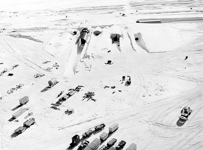

DMD Posted March 6, 2009 Author #6 Posted March 6, 2009 PM-2A (1960 – 1964). This reactor was located in Greenland at Camp Century, an army arctic research center built completely under the ice. Camp Century was used to learn how to operate in the arctic environment. The Arctic Engineer Task Force did experiments in storage and living conditions and the Army's Transportation Corps tested special Arctic vehicles. PM-2A was the world's first portable nuclear plant and produced 2 megawatts electrical plus 1 million Btu/hour steam heat. The reactor was removed and shipped home when Camp Century was closed in 1967 because of movement of the glacial ice.

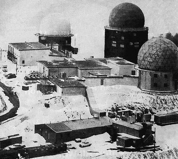

DMD Posted March 6, 2009 Author #8 Posted March 6, 2009 PM-1 (1962 – 1968) was used to provide electrical power to a remote Air Defense Command radar station near Sundance Wyoming. The plant generated 1250 kilowatts and was operated by the US Air Force, 731st Radar Squadron. The reactor was built underground.

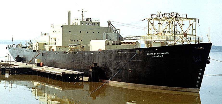

DMD Posted March 6, 2009 Author #11 Posted March 6, 2009 MH-1A (1967 – 1977) was the first floating nuclear power station. Mounted on the Sturgis, a converted liberty ship, it supplied 10 megawatts electricity to the Panama Canal Zone from 1968 to 1975.

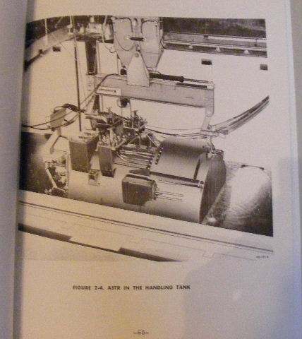

Plant#4 Posted March 23, 2009 #25 Posted March 23, 2009 ASTR or Aircraft Shield Test Reactor. Here are a few pics from a Convair manual for the ASTR, this one was ment to be flown around just to show that it could be ported, they had another one that was not flown, but was used in testing. It was shielded by water, and the crew was also protected by a large lead baffle system. They had a lot of assets following this aircraft around when it flew, recovery equipment and a detachment of Marines as well. Dave
