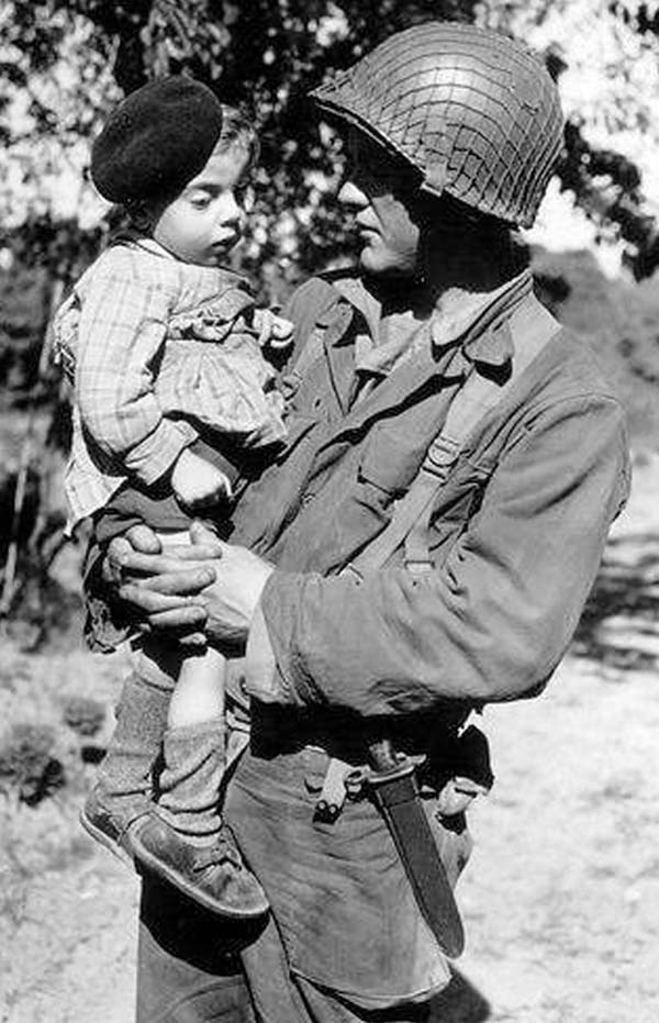

Gregory Posted September 9, 2018 #15 Posted September 9, 2018 In mid-1944 most likely both sides of France, North and South, saw M4 bayonets. Below there is a photo captioned "US Soldier with French child, Normandy, France 1944". And the soldier has M4 in M8 scabbard. The photo by Signal Corps. M4s were there and then and, perhaps, this is why Ordnance technicians tried to manufacture lugs for them using in-house methods before standardized lugs arrived from the USA, as Maj. Gen. Weaver writes about it in his memoirs.
doyler Posted September 9, 2018 #16 Posted September 9, 2018 Im seeing a Garand bayonet..the scabbard is longer and the top of the scabbard metal plate is flat. All M8 scabbards had a angled edge on each side of the metal top plate whether the M3 or M4 was carried. Also the grips are not grooved on the bayonet in the photo.They appear to be flat
Misfit 45 Posted September 9, 2018 #17 Posted September 9, 2018 Your information is good, but the photo shows an M1 bayonet. Note the release button by the guard. Marv
