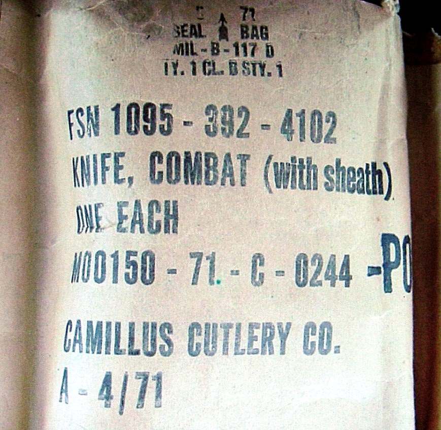

What year did Ontario produce this knife? I just received one that belonged to my uncle and I'm curious.
What is the oficial designation of this knife?

Ontario received their first contract in 1980 and are the sole supplier now.
Photo is of a Camillus in package.

Thanks for the info Gary. It has been a big help! Best regards, Rod
