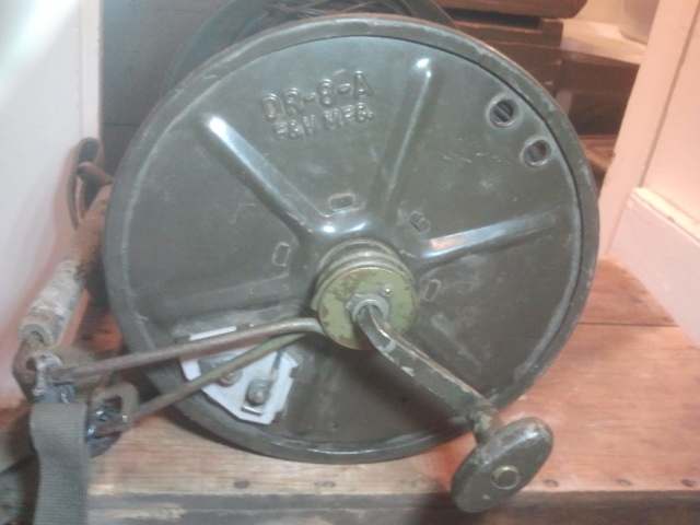

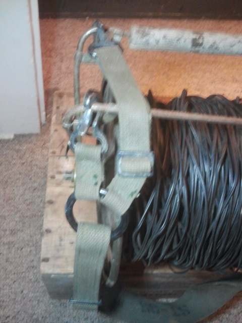

pushingtheenvelope Posted March 18, 2012 #1 Posted March 18, 2012 I picked up this roll off communication wire for a field phone at a flea market today. This is my first roll in my collection so I don't know much about it. It is manufactured by F&H MFG. and is marked DR-8-A. On the handle it is marked RL-89-B. The strap is marked ST-35. I would apperciate some information on this.
hawkdriver Posted March 18, 2012 #4 Posted March 18, 2012 Your reel is a DR-8-A like you stated, yours is the darker OD making it pre 80's. I don't know exactly when they changed over from the darker OD to the newer green CARC. The handle has a cotter pin in one end of the axle that you can take out and remove it from the reel. The ST marking on the strap shows that it is used for communications, which this is what it is used for, holding the reel crank while you spool out the wire or wind it up. Your reel is a 1/4 mile reel, they do make a one mile reel, it's about two feet in diameter and sits in a cradle that you mount on the back of a truck to operate. These reels are used in squad to company level field phones predominately. TA-1's, TA-312's and company switch boards.

hawkdriver Posted March 19, 2012 #6 Posted March 19, 2012 Check the thread on the straps, is the thread nylon? If so, it is probably vietnam vintage. If not, probably somewhere around KW or twixin the wars.
