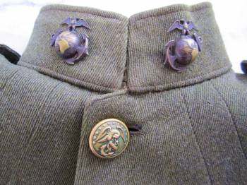

As promised, the birds on the officer's FG coat (note the six pointed stars on the officer's button). Again, thanks to teufelhunde and Jeremiah for your help in putting this set together. Cheers, Bill

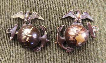

Close-up of the Gemsco birds after balancing the patina. Cheers, Bills

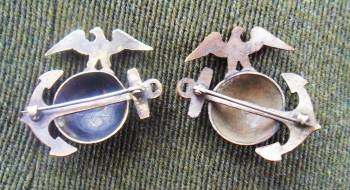

beautiful pair. Were they originally a lifetime match?
No, one bird came from Jeremiah, the other from eBay. However, both EGAs are Gemsco. Both have identical pins and 'C' clasps. Both were originally painted the identical 'chocolate' color and both had the identical amount of wear. Someone had tried to 'touch-up' the paint worn off the continents on the EGA from eBay with what looked like nail polish. After removing the nail polish (which took off the original patina as well) I cleaned both EGAs with a mixture of vinegar and salt which removed the patina from both EGAs. After drying them I suspended both of them for about half an hour in a jar with a bit of ammonia. The ammonia vapor does exactly what nature does...oxidizes the brass..only faster. This returned both EGAs to the patina that was on them before cleaning. I think the 'restoration' really turned out and another pair of EGAs will now live on for another 100 plus years. Cheers, Bill
