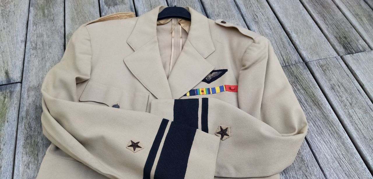

Inter-war Rear Admiral tunic

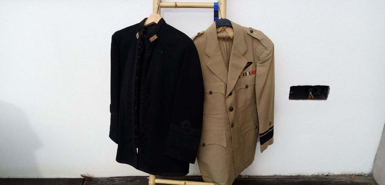

Hello
Got this nice flag officer tunic for a rear admiral
Notice the Navy Cross and the Grand officer of the Légion d'Honneur
Unamed
And with former ennemy
Thanks for looking
Louis.

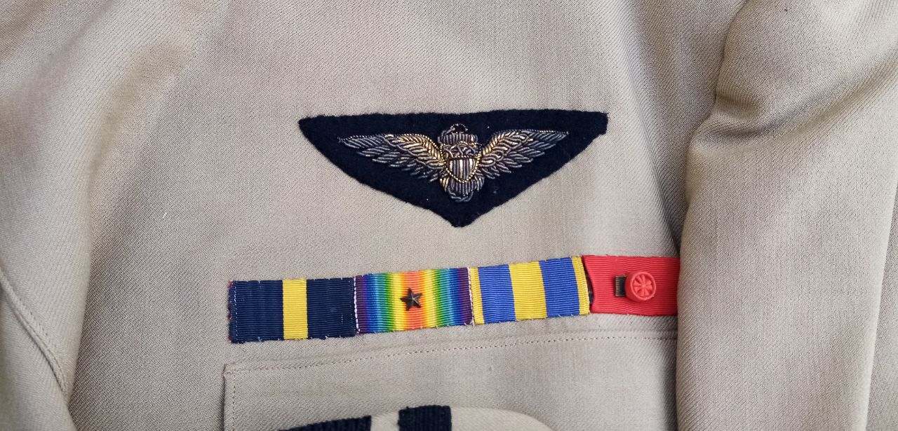

The first ribbon bar is for the Navy Distinguished Service Medal. The Navy Cross has a white center stripe.

Hello
Apologies for the miss identification  !
Still a hight hand award for our Amiral 👍

A very cool and rare piece.  I've never seen a flag rank khaki blouse with the black sleeve rank trim.  Great find!!

This one is part of 1922 - 1941 US NAVY regulations
Quote
On 22 June 1924, the Chief of the Bureau of Aeronautics directed a letter to the Secretary of the Navy strongly recommending the authorization of a kahki uniform for summer wear and a heavier one for cold weather. He suggested that such a uniform could be used to advantage by all officers whose duties involved working with machinery. This idea became a reality just prior to World War II! A working dress was authorized on 8 April 1925 for “Naval Aviators, Observers and Other Officers detailed to duty involving flying.” The newly authorized coat was not like that of the recent war but a modification of the new service blue sack coat. The self-belted, single-breasted khaki coat was fastened with three bronzed buttons, had a rolling collar, notched lapels, a pocket on either breast and two lower bellows pockets
See more there
https://www.history.navy.mil/browse-by-topic/heritage/uniforms-and-personal-equipment/uniforms-1922-1931.html
After the 1941 regulation, all flag ranks where on shoulders

#6
This raises some real questions for me. The pre-1941 khakis were all cotton twill, this looks like wool or a blend. As a "wash" item, the coat used removable wings, ribbons and buttons so they didn't have to be re-sewn. Are the black stars on a wool backing?
The pre-WW2 khaki coat had bellows-style lower pockets; they were not changed to the flat patch style until 1947-48, around the same time that wool khakis—which became an option during the war—became "service dress" rather than "working."
The shoulder loops are unusual, too. They were usually long enough to be covered by the collar, and pointed, not blunt on the end.

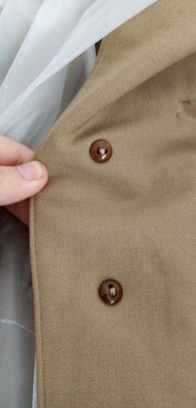

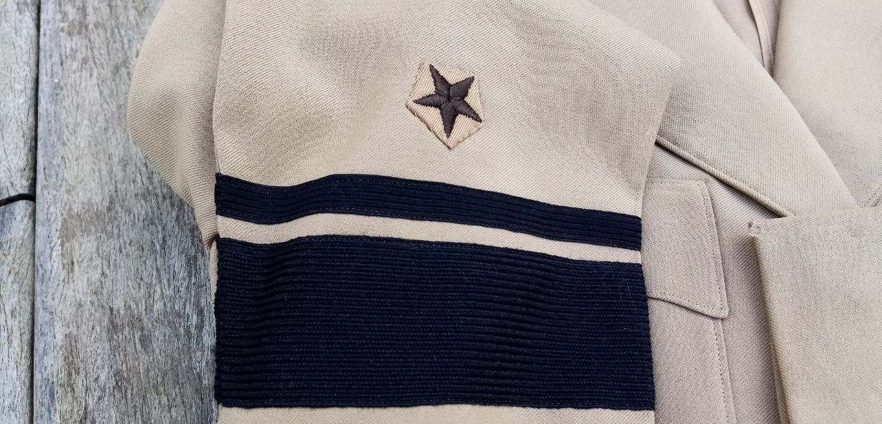

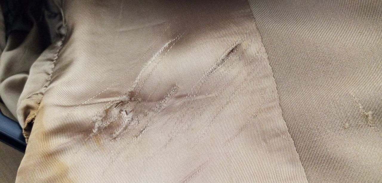

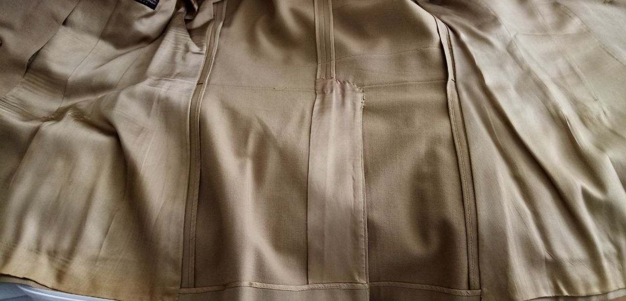

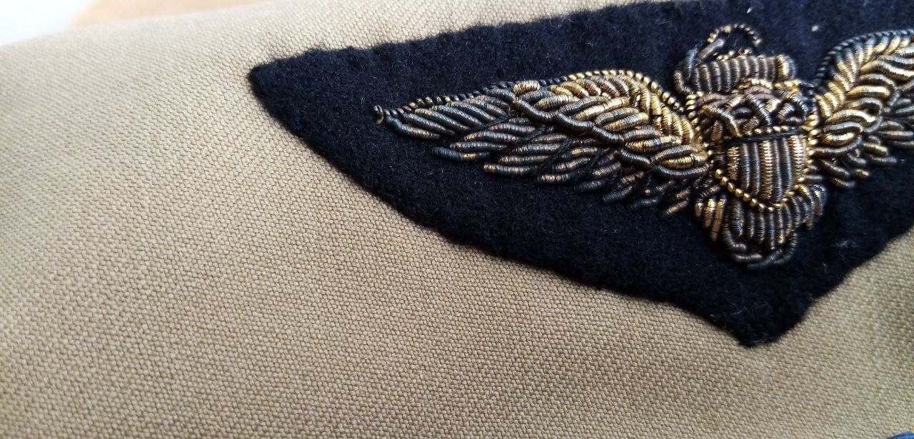

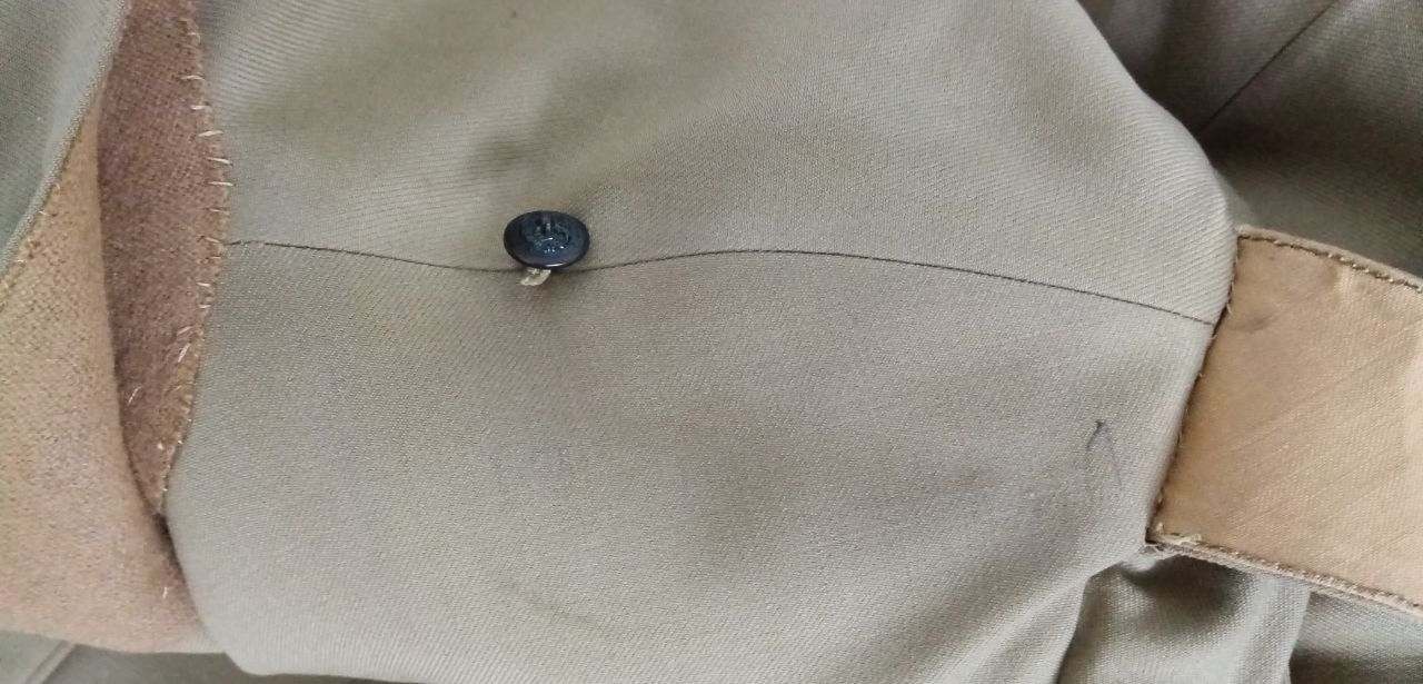

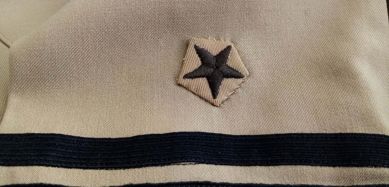

Some more pictures
Pocket tissu, for me it's not wool
Star, on a cotton backing
Wool based wing
Behind of it
Interior of the coat
And Shoulder board

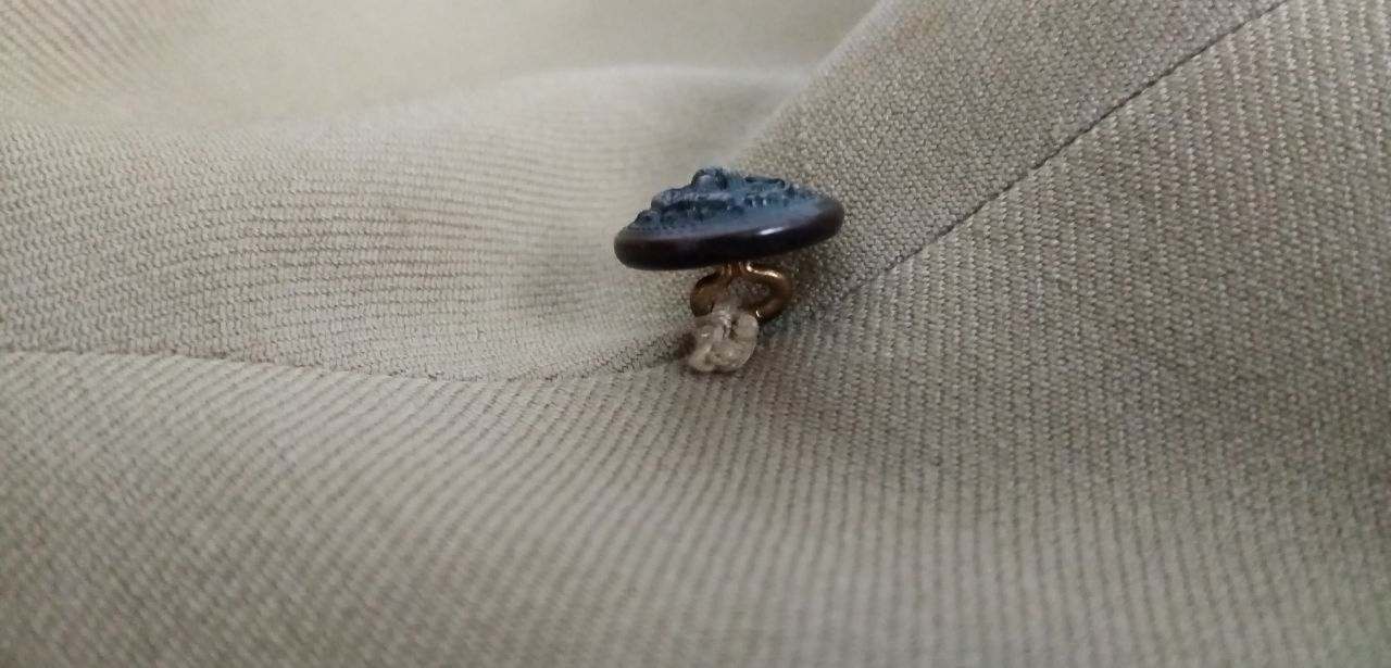

I forgot a picture of the buttons
Coat unamed, I have only a tailor label
But , as I may be wrong with the date, I don't think for a "all put together"

1.  Spanish American War service (noted the ribbons are out of order)
2.  Naval Aviator
3.  Still serving 40 some years later in 1941
4.  DSM
5.  Looks like a French Legion of Honor ribbon?

I look at things as "wrong" until I can explain them and gain comfort with it.
In this case, to me this looks like a 1940s or 50s (or later?) Navy officer's khaki uniform jacket that someone sewed cuff rank on. I have yet to convince myself otherwise. Can anyone point out where this jacket (sans insignia) is different than any other kahki uniform jacket? Happy to be wrong.
Tagging @KASTAUFFER as he knows these pretty well.

More pictures of how the uniform is designed
Arm rank
photo_2024-03-13_17-01-46.jpg.f7e2ce3a6db6fd6a7e93182eca3ad20c.jpgphoto_2024-03-13_17-01-47.jpg.32d306e3db4c646cb7b7009394d4217d.jpg
Interior

Looking at the uniform and comparing it to the few photos of real ones, I'm not seeing anything that couldn't have been put together by someone. The cuff rank is easy enough to buy and sew on, the ribbons are easy to create and sew on, and the wings are available...and again, easy enough to sew on.
Thus far, I'm not seeing anything that's "this HAS to be a 1930's khaki" uniform. Again, happy to be wrong if something is obvious that I'm missing.

Sorry, this just does not look like a pre-WW2 working khaki coat.
The buttons were changed from bronze to gold in April '41, before the new Uniform Regulations were published in June with the eagle direction change, so there would be no reason to put new-style bronze buttons on a khaki coat.
The pre-WW2 navy khakis were very much thought of as a hands-on working uniform, meant to go through the ship's laundry. The lightweight tropical wools (Palm Beach, TW etc.) were expensive and would be very unlikely for a working uniform at that time.
I have never seen a period photo of pre-WW2 or WW2 working khakis with embroidered wings. It was non-regulation, and it was impractical as well.

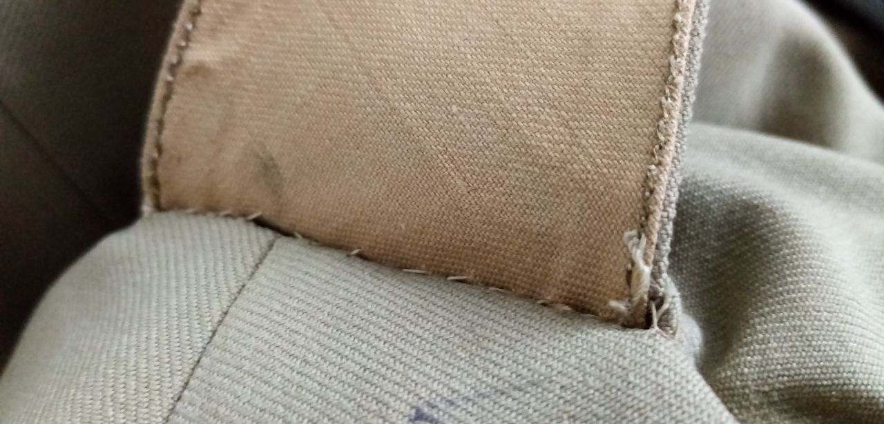

Louis, are there any traces of former shoulder board attachment loops under the shoulder straps?

Hello Justin
Here is the pictures
Not any trace of a attachment
Louis.

Hmmmm.  Good point, Dave.
I think the key is analyzing those shoulder straps.
In the one photo you can see some stitches/threads at the base of the strap.  I looked at a number of other various uniforms I have.  Stitching / threads were not visible.    So, that’s not good.  Possibly added later.
The eyelets (opening for the button) on the straps should  be compared to those on the pockets and down the front. I would think the stitching  should all be identical.
The one component not easily available would be the line officer stars. Can’t think of any other uniform that would have these.  Would have to be manufactured.

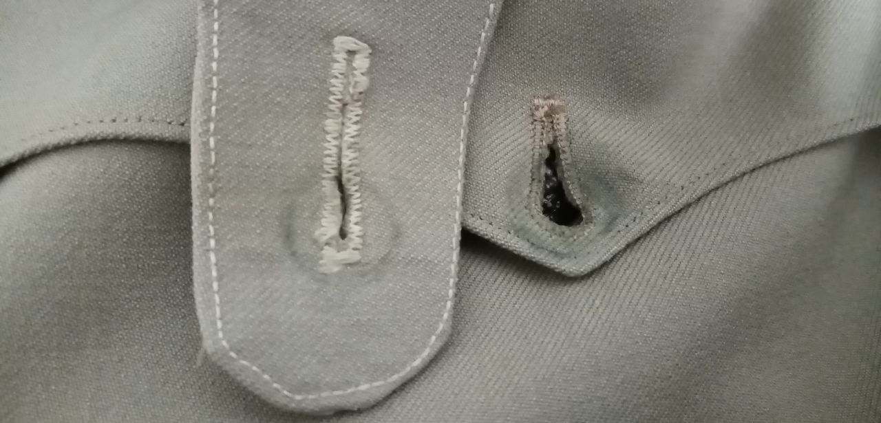

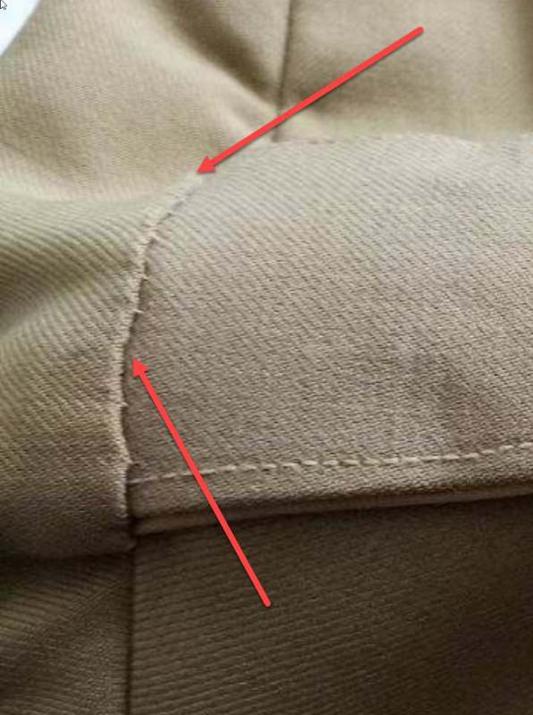

#21
I'm seeing some very rough hand stitching on the shoulder straps. Also, the backing of the shoulder straps doesn't match the lining of the jacket...something you wouldn't see on a jacket from a high-end tailor.
Keep in mind these were sold without shoulder strap loops when Chief Petty Officers were authorized to wear the uniform, so missing the loops isn't a tell-tale sign.

You are right, that's not how a Hight end tailor would present the uniform.
Here is a picture of tunic button holes VS tunic button stars
photo_2024-03-13_17-56-49.jpg.dd05f2b36d16676fea385998be86ba64.jpgphoto_2024-03-13_17-56-49(2).jpg.c658b09b84390446af86397bb20852db.jpg
Well that one of a kind to have faked this one
I'm mainly on French Generals and I will keept on it ! :)
(Or just US army generals)
Tunic was brought  from James Military Antiques (JMA)
Louis.

It all appears to me to be too crude in workmanship, especially for a RAdm.  Looks to me like someone doctored a late 1940's CPO blouse.
#24

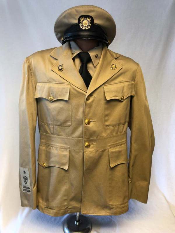

When looking at the internet :
https://wow.uscgaux.info/content.php?unit=A-DEPT&category=uniform-1950-1
With different shoulders and pockets flaps and you got it

#25
The shoulder strap eyelets  being so different seal the deal for me -  uniform is a rather well done fake.
