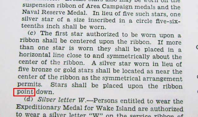

Here's an excerpt from the 1948 Navy Awards Manual, which states "Stars shall be placed upon the ribbon point down."

The navy gold stars very frequently had their gold color come off over time. In fact I'd be suspicious if they were NOT bronze. Also, Tom is correct regarding the upside-down stars. "Stars shall be placed upon the ribbon point down" is the wording in the 1942 regs.

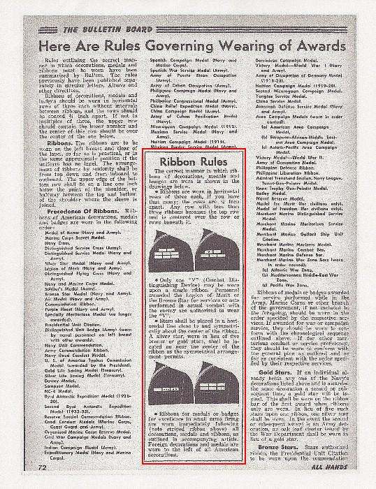

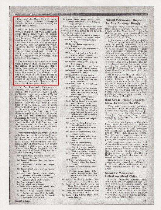

Still looking through the early (1942-'43ish) stuff but, here some information that might help.
** Quick note, as the image size is limited to 150 kbyt here, the images are not the best but I'll attach a full page, then a closeup of the highlighted area for ease of reading. **

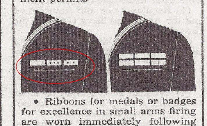

In the June 1946 All Hands Bulletin, a bulletin board section was devoted towards the uniform/medals regulations of the time. They did this every few years before and after this specific issue. In that, it took excerpts straight out of the uniform regulations and included it in All Hands.
On page #72, they discuss service ribbons and show a figure depicting the correct wear and setup of how ribbons and attachments are to be worn. However...

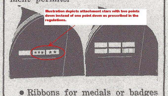

#16
... If you look at the figure, the ribbons depicted actually show the stars with one point up and two points down. This was contrary to the actual written and prescribed regulations on wear.
#17
On the following page (pg. 73) in All Hands, the regulations continued and the actual wording spelled out that the stars were in fact "point down".
I think many people simply looked at the figure and never bothered to read on. This is where, IMO, the confusion came in, along with the fact that the actual regulation had the figure incorrect and did not change it.

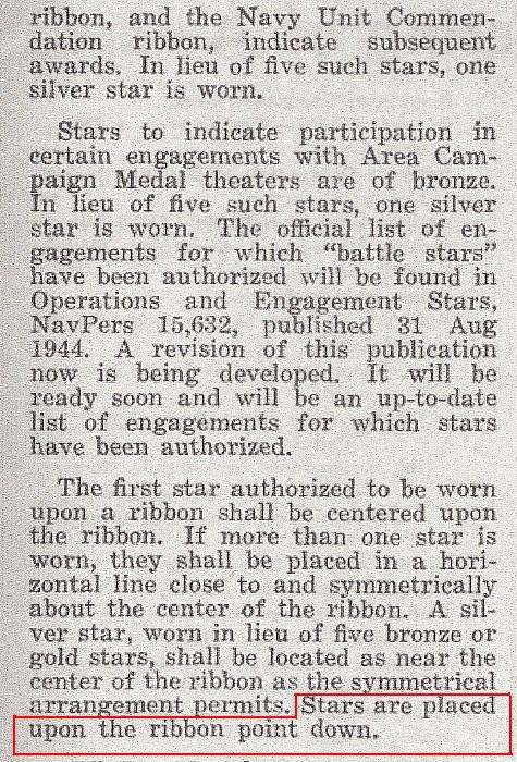

#18
Sorry for the terrible resolution on these. :crying: Here's the closeup:

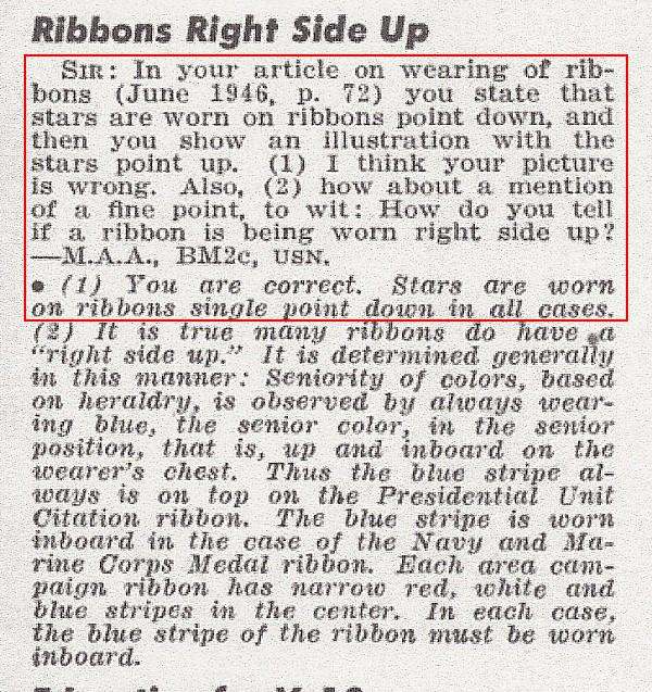

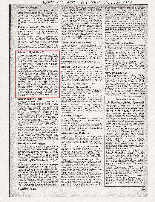

As these bulletins go out to the Fleet, there are always people that like to prove the editor or author wrong, whether its a case of trying to show someone how much they know or just to trip up those supposedly in the know, it doesn't matter. However, over time, this kind of provides a check and balance to the system and keeps the information correct.
In this case, two months later, in the August 1946 issue, a reader questions the editor on the accuracy of the past (June) issue relating to the position of the stars.
#20
Assuming I am reading this correctly, this BM2 is also functioning as an MAA and probably in a position of enforcing uniform regulations at his level and wanted to know the bottom line.
You can read the editor's correction and note, it applies to ALL stars, regardless of award type or level.
Hope that provides some answers. :thumbsup:

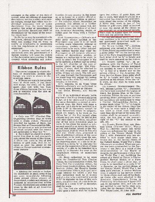

I wanted to add, that in the following year, the July 1947 issue updated this uniform regulation section and on page #36, shows the same figure as before however, it appears the stars have been rotated to correctly depict the single "point" down. Unfortunately, the resolution is almost impossible to tell accurately 100%, but it looks that way.
Additionally, the written narrative now spells out specifically, one "ray" down.
#25
The new figure.
