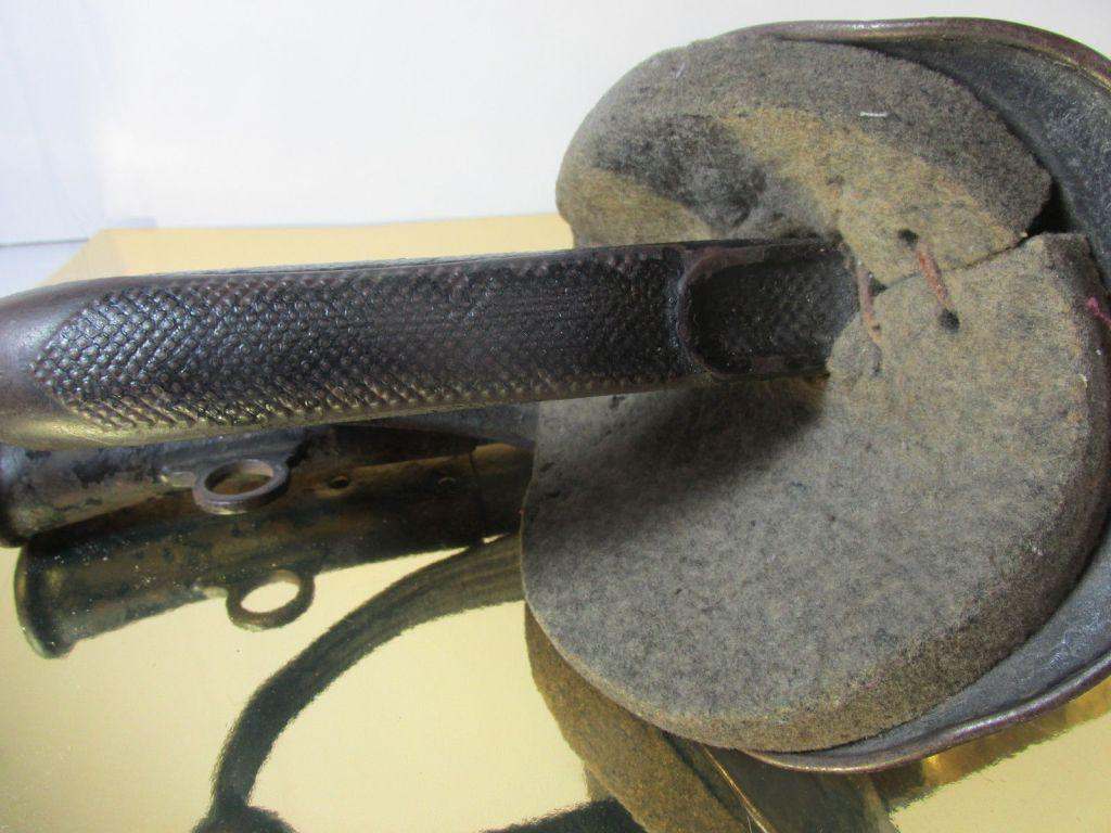

Attached is a shot of the hilt of a M1913 LF&C saber. Is the padding something which was normally used with these? I don't think I've seen one before.
#19
Hello:
The felt pad you see on the LF&C saber is a armory sponsored item. It was intended to absorb some of the impact shock derived from contact. They are fairly uncommon to find these days. I will look for the actual paperwork from the armory this evening and try to post additional info tomorrow.
Pony Soldier
#20
Sergeant R.E. Futch, an Assistant Instructor of Swordsmanship at the Cavalry School, made the first pad from the felt in saddle pads, and recommended them for adoption in May of 1923. The recommendation went forward and testing on variations of Futch's pad was completed by January 1924 and final approval was granted on 14 March 1924. The pad was mandated to be a regular issue item, at one per saber, in Circular 58 of 1924.
I have copies of the correspondence and test report.
