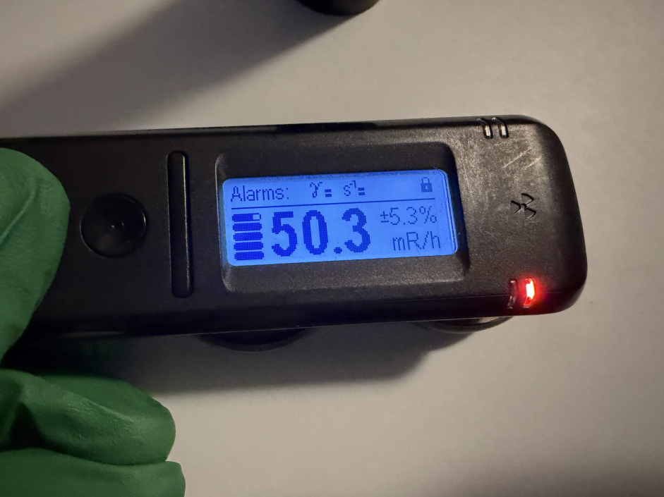

Each marker has a radium activity of around 10-20 microcuries. These are not harmful to handle short term, but it's not something you want to wear around for days on end.

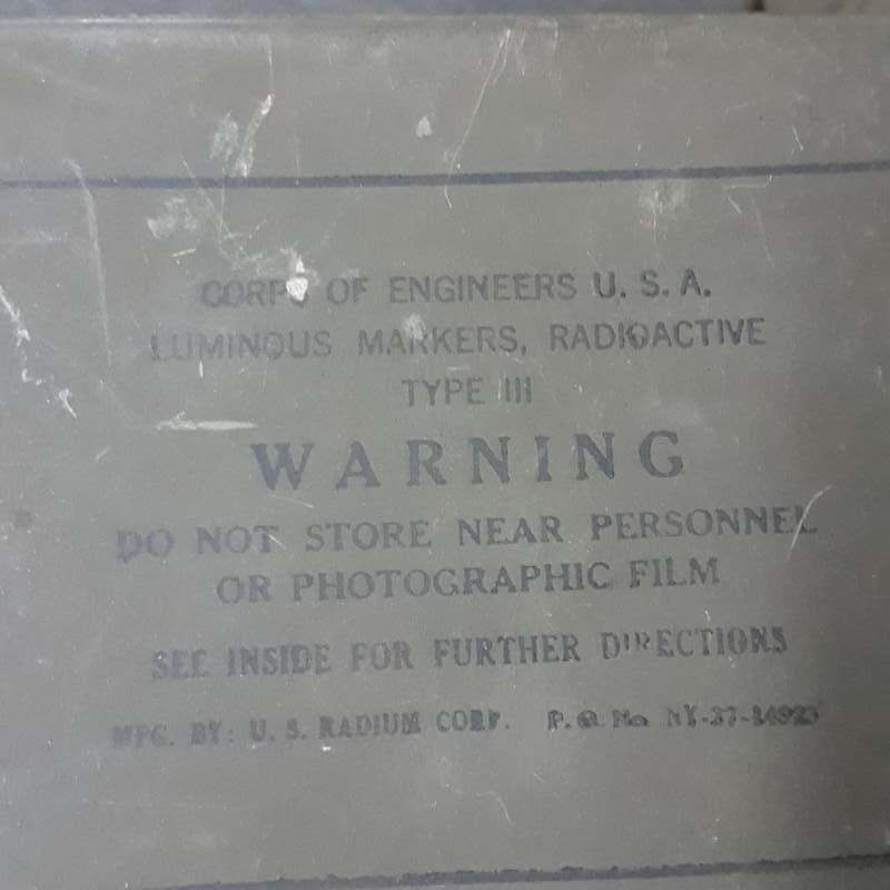

Alongside the Type 1 disks, were the Type 2 and Type 3. Both of the latter types are much larger and don't have holes to tie string through. The Type 2 was manufactured by the Corps of Engineers for marking stream crossing bridges and trucks- they were fitted with a large bolt and nut on the back. The Type 3 was utilized by the Navy to mark decks and personnel at night. It is equipped with a middle prong to wear on personnel, alongside two prongs that extend on each side to be screwed onto deck bulkheads. I am actively searching for a Type 2 and Type 3 for my radioactive collection.

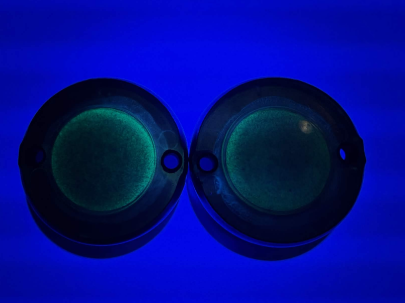

Disks phosphorescing under 365nm UV
50.3mR/h (or 503uSv/h) on contact with a gamma scintillator

Lead lined steel box for Type 3 discs.
