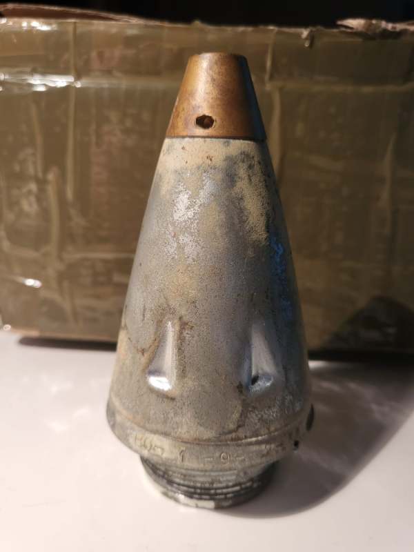

Hello everyone,
I've recently purchased this M51A5 fuze (postwar), which is almost identical to a M48 and a M51 fuze externally.
The problem is that I can't disassemble the head from the ogive (the big body just under the head), I hope I'm using the correct terms.
I've noticed that on the back there is this small dot:
It looks like a sort of small welding point or something like that.
Could this be the reason because it's not possible to disassemble it? Is there something I can do?
Thank you for your replies
I am not sure why this hasn't been replied to. I'm getting around to catching up on this forum. Anyway, looks like the dimple is a form of staking to keep it from coming apart. The very top brass part would unscrew from a shaft that is attached to the solid base of the fuse. The center section is a fairly thin stamped part that is held in place between the top and bottom piece. Once the top brass piece is unscrewed/removed, the thin metal windscreen will just lift off the base (if I remember correctly). That staking looks pretty deep so may not be easy to remove the top part without damaging it. There's not much to see under the windscreen anyway.
Might be able to drill the stake
I would leave it alone, forcing or drilling it will end badly.
