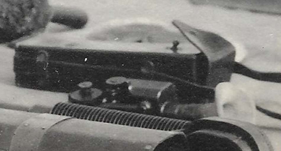

That's a very cool image, MWalsh.  Looks like there is a Warney Swasey scope in the foreground with its leather carrying case with the shoulder strap.
Thanks for the post.
Charlie
Charlie - Geez, I never even noticed that! But you are 100% correct! Great eye!!
#8
Related to that.... Is this the mount for the Warner Swasey? Looks like a rail type piece?
