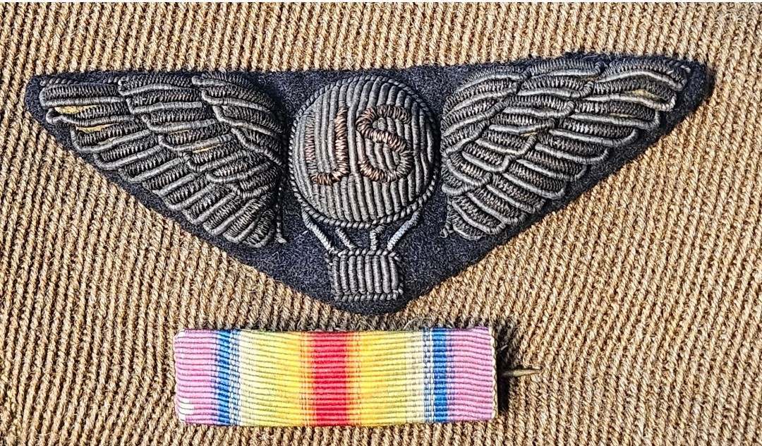

On a uniform that I have, this is what an original should look like.  They are scarces as hell and out every 100 out there only 1 will be authentic.  Matter of fact it was reported that over the last 25 or so years only 5 or 6 sold in the open market that had been recorded.  Realistically, these bullion wings are rare then hens teeth.
Aloha,
John
Thank you for an authentic piece, and yeah, I figured they’d be super scarce and took a chance on a small selection of items.
You got a beautiful item there 👍
