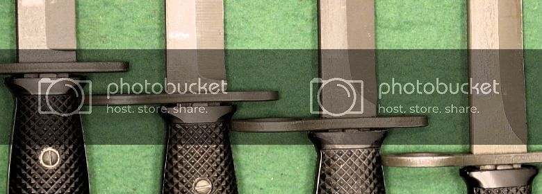

In the photo below, based on observation more than any official sources, from left to right:
1. The normal early style runout found on most of the early M7s. They do not have quite as sharp a corner as was common in the M3, M4 etc.
2. The later official style of runout with a rounded corner. This was apparently done to stress relieve the corner, although what documentation I have found does not state the exact reason. and I have not yet found an exact date for the change. MilPar may well have used this style of runout.
3. Although somewhat longer and more rounded than #2, this appears on the very late production M7s and is probably within specifications since the spec simply states "Configuration of runout may vary - sharp corner not permissible." It is late enough that in the case of MilPar it should be considered commercial since it does not appear until after MilPar went out of business.
4. This long slope is almost certainly commercial production.

Thanks for the info. Gary. Still no luck on finding an FZR marked specimen (yet) but I did manage to find a well used Milpar marked specimen with what looks like runout #2. I need to post a photo if it so you can tell me what you think.

Gary,
Here is a close-up shot of the Milpar M7 I now have in my collection:
It appears to match the second type backcut you listed.

Since this thread is back up right now, I would like to correct some of my previous statements based on information that has came to my attention since my first book came out.
MilPar had late production of the M5 bayonet and possibly also for the M7 that did use the long slope/curved backcut/runout. The M5A1 bayonets were made for other countries on Military Assistance contracts, not for the US military. Some of these came in with the batch of bayonets the CMP brought in from Greece. It looks like they may also have had Military Assistance contracts for the M7 although I have yet to find proof of that - so it could be that the long runout M7 bayonets were made through a military program for some other nation, not necessarily for commercial sales.
