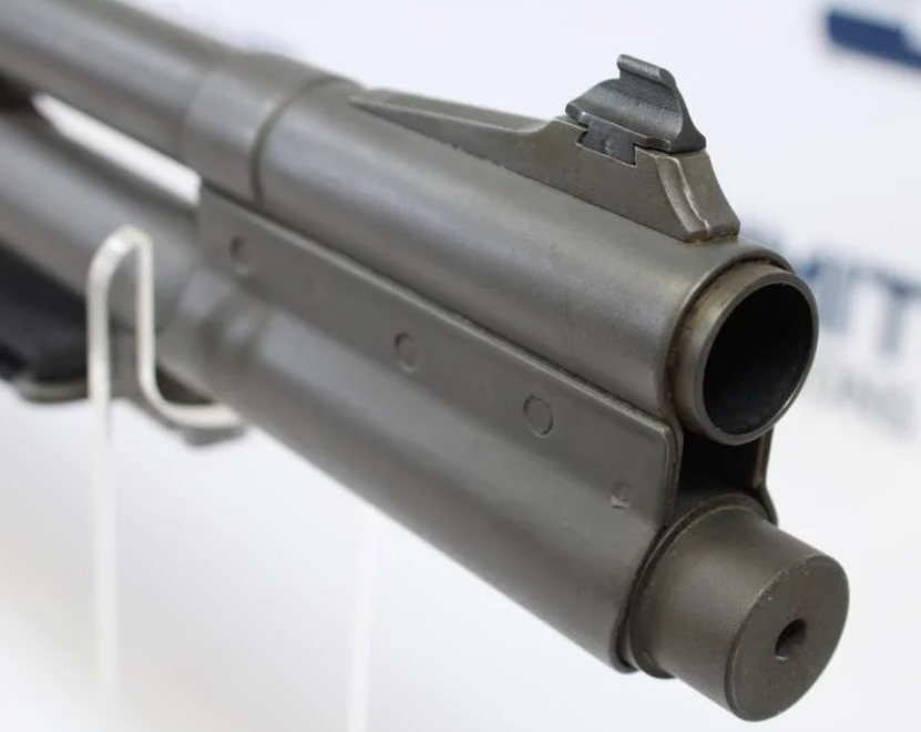

That is one clean machine.  I took a few of your auction pics and reposted them here.  (Pics hosted on an outside site often disappear and render a thread like this nearly useless without them, so our Forum greatly prefers pics to be posted here to preserve the integrity of the thread.)
Charlie

Two things stick out as issues to me.  The first is that the magazine tube sticks out beyond the muzzle of the barrel.  It should be the other way around with the barrel being slightly longer than the mag tube.  You can see this in the photo Charlie posted above.  The barrels were 21 inches on the Mark I whereas regular Model 870 riot guns have 20 inch barrels.  Also, the Mark I barrels had a "MOD" choke mark on them.
The second thing is that the serial number (S755216) is higher than the Mark I shotguns I have seen or have data on.  There were only just over 3,200 of these shotguns ordered in a 1969 contract, and all of them that I know about fall into a small serial number range from roughly S08xxxx to S128xxx.

Besides not seeing a MOD choke mark on the barrel, the barrel date code does not look right.  The first letter is the month the barrel was made.  The second letter is the year it was made.  A 1969 made barrel would likely have a barrel year code of either an R for 1968 or an S for 1969.  The second letter on the subject gun does not look like an R or an S.
