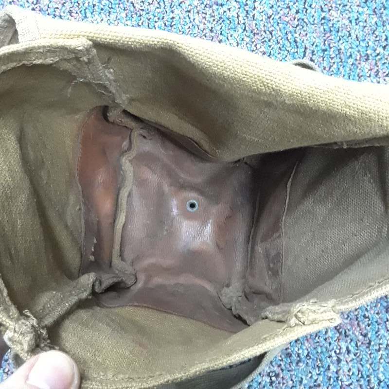

That booklet I show, on the next page, lists a Grenade Carrier. I believe that refers to the 3 snap pouch. So, there are two different bags listed. Now refer to the quantity of grenades each member of the hand bomber section is allotted.  I tested the quantities in both bags. I put 10 grenades in the 3 snap carrier bag and while more will fit, 10 seems to be the maximum weight that that bag would carry comfortably. Then I tried 18 grenades into the bucket. 20 will fit easily, and the wider strap makes it feel right. Plus, the leather reinforced bottom, I can see, would be advantageous.

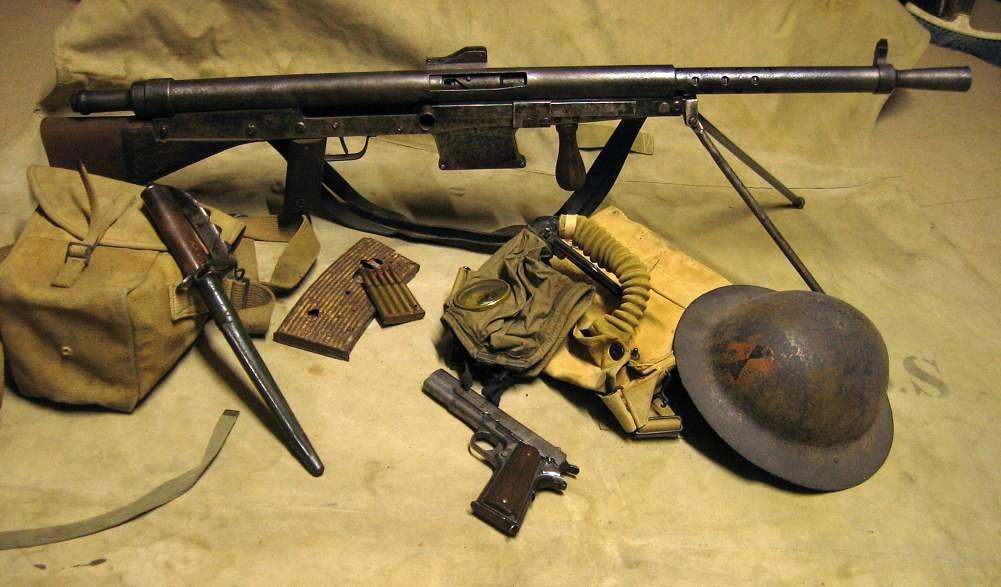

The US shosho in action. It is difficult to distinguish the equipment with certaintyscchocho2.jpg.20229454cbb62858b80b9b5c9f424d83.jpgscchocho3.jpg.265730030d80992885610654a329132d.jpgscchocho.PNG.7f9c5e8b978bbd10280b9ce5f16a7f90.PNG
Yes, that's the problem. I've seen images of Doughboys using the French magazine pouch, but no images with US accoutrements.

The bag shown is a Chauchat Magazine Carrier.   See description below from a 1918 contract.  Sorry I do not have a drawing for it.  The Grenade Bucket is a very distinct item.  I personally have never seen one in a photo or in person.
