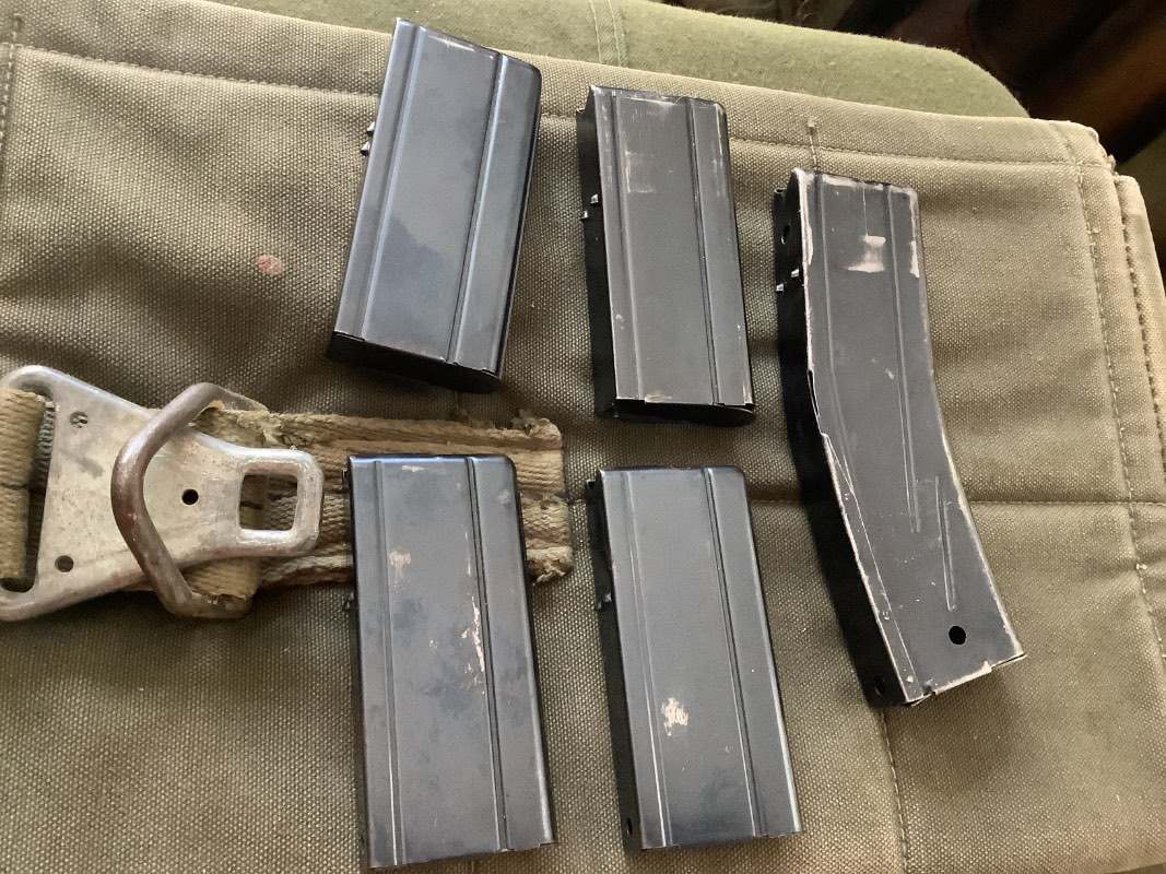

Early production M1 Carbine.Inland. Five mags.
I have no idea of it’s worth with the recent M1 Carbine craze. The barrel date is 1-43,  I searched CMP auction prices- prices all over the place. I didn’t buy the story, but the gun….the “ story”, a GI bring back handed down to his son, then step grandson, then to a relative who had no interest in it what so ever.
Barrel marked: “ INLAND MFG. DIV
                               GENERAL MOTORS
                               1-43 “
Four 20 round mags, one 30 round mag.
20 rd mags:
-IU in a circle
- AI
- U-S’G’
30 rd mag:
- SEY
All thoughts and information appreciated.

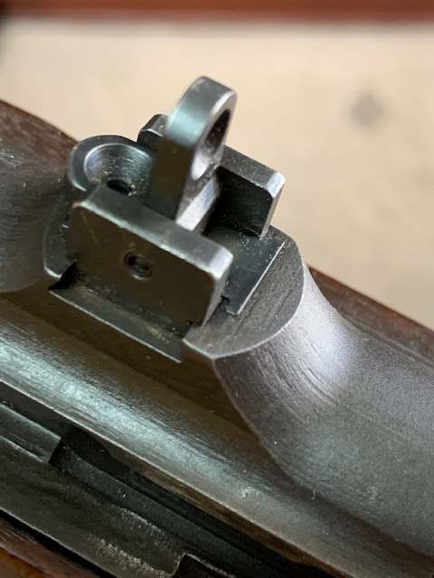

The alum disk is prob a rack number but is not original. High wood, eye cut stock is proper for a 43 Inland,  more pics of the inside parts and good close up around the base of the rear sight.  If no import mark, $1800 to $2000+ depending on what is inside.  Nice pic up.   Those are 15 round mags.

Not sure what sort of info you're looking for.   Overall visually looks nice enough.  Close up photos of the details will help us see whether the parts are likely to be the same as it left the factory with, whether its been 'restored', etc.  Even bring backs could have parts swapped around depending on circumstances.

917601, your rifle looks promising. I cut stock, push button mag release, correct barrel band, rear sight, etc. are all correct for the gun. Some more pictures are needed though. With the correct internals, the value goes up. Inlands are the most abundant but the early ones tend to be more desirable. I’m with Dirt Detective on the price. $1800-2000 is a good starting point.

You forgot the + after your $1800 - $2000 that was stated.   We need to see pics of the inside and around the rear sight, stock markings and more, does it have a dogleg hammer?? .  18 to 20 is a good starting point until more is known.  I agree with you quality original carbines are going for more.
