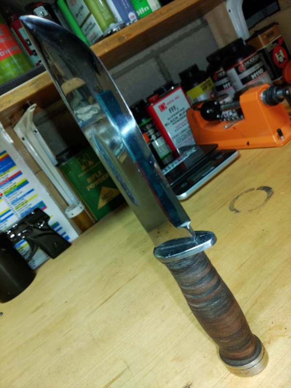

this next one i regret, in retrospect i ruined a perfectly beautiful knife.  here goes anyway
cattaraugus 225Q

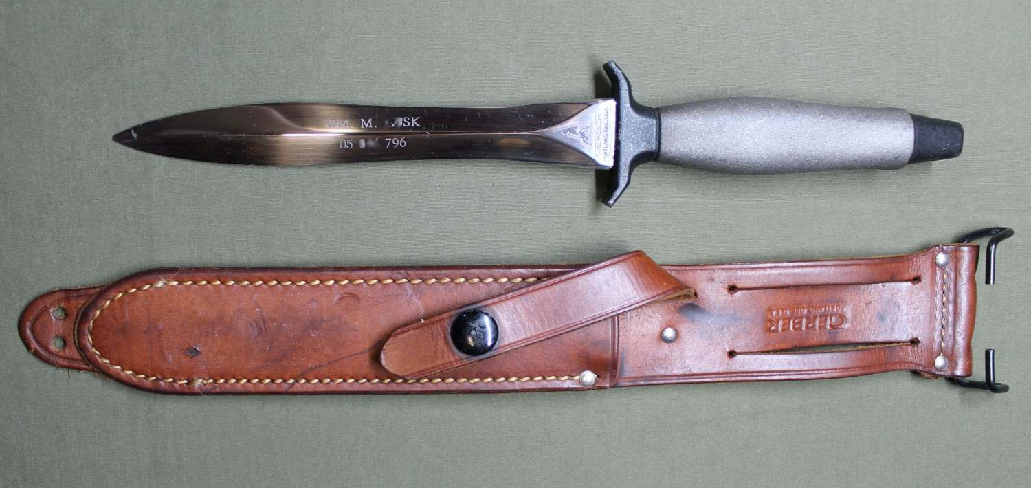

Very nice work.  I usually don't try to restore a military knife unless it is no longer salvageable as a representative example of an issued knife.  The first one is an M3 that had its tip broken off and reworked.
The second is an Everett knuckle knife that was badly sharpened. I didn't try to restore this one, just make it presentable.   I didn't paint it because I like it the way is is.

wow!  nice job on both misfit 45!  i completely agree with you regarding the "authenticity" of leaving a military knife alone.  the character they have should be left intact seeing as many of them have been to hell and back.  i'm curious about the M3.  it looks like there is only a little bit of the tang exposed in the before picture.  how did you go about attaching the pommel to the beautiful rehandle job?
#10
Since the blade was shortened, I didn't see any problem with shortening the grip length somewhat as well.  I made a new pommel plate and allowed about an eighth of an inch of the tang exposed....more than enough to peen.  However, I also cheated and used some JB Weld just in case; no pun intended.

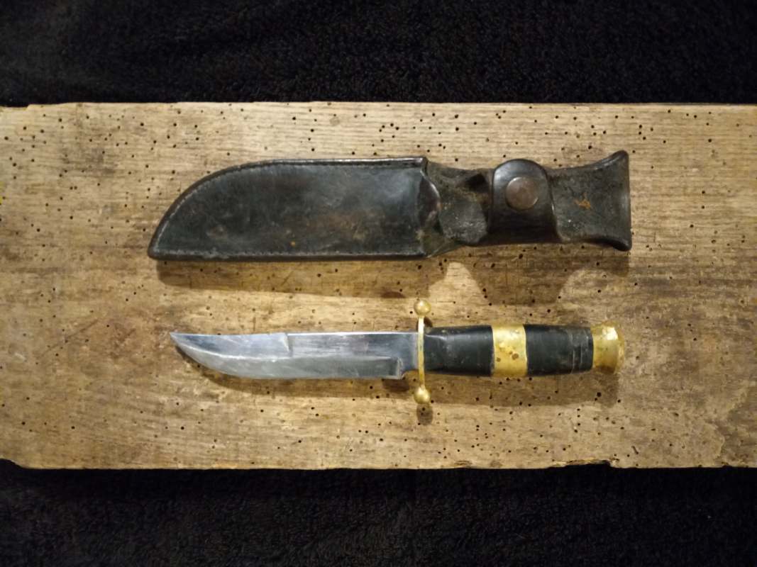

Here is my take on restoring and a recent restore of an RH36. First, I find the resto process very relaxing. I know about the folks who cringe at the thought of restoring a military knife, but you have to take into consideration that probably 95% of the knifes look has occurred since it left service. I certainly can't afford to pay hundreds of dollars for an M3 so I get many of the items on EB that no one wants. Then bring them back to some semblance of what it should look like. Think of it as a broke down rusty classic car.
Sorry for the ramble. Here is a PAL 36 I just did. Oddly, I took no before pics of the knife, but here is the sheath before and the finished knife. Sheath might need work.Thanks.

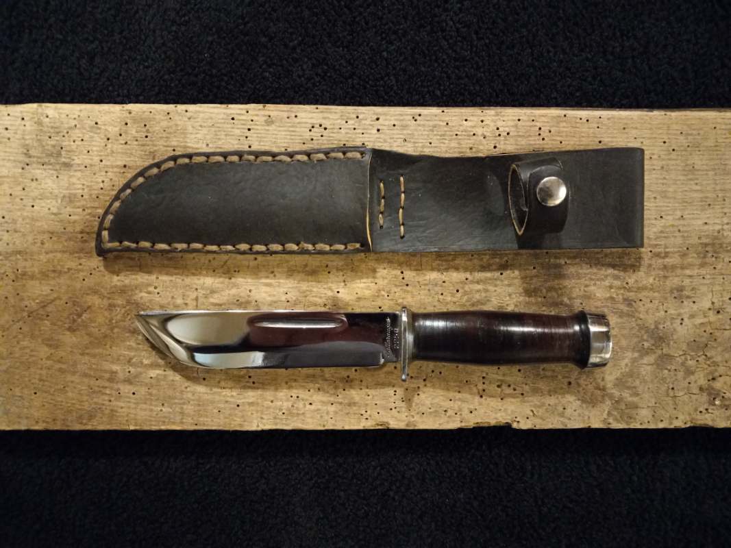

Here is a Cattarugus that was badly rusted and had a nickel sized chunk out of the edge. Junk to jewel.

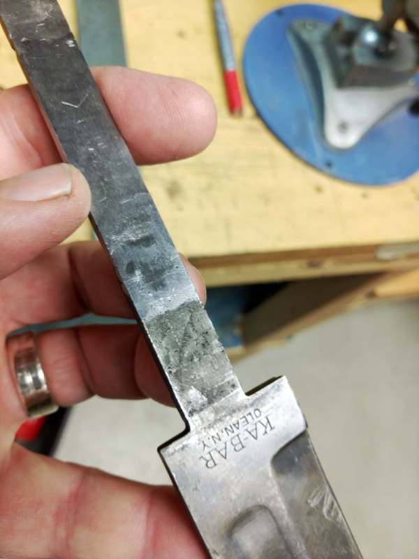

you can hardly tell that Robeson was repaired... I just started my first official rehandle a few days ago, a Kabar 1205.  you can see in the pic below that the pommel was somehow snapped off leaving two "fingers"
#20
i removed the old handle, ground the fingers to an even length and opted to weld a 10-24 bolt in between the fingers (which was just a little wider than the tang itself, then ground down and sanded the weld
#21
i installed the spacers and leather washers today, i have it all clamped together in the shop right now so no pic yet.  but i'm going to use brass for the pommel and tap it to 10-24.  i'll post pics when i get er done.

martyb, i'm just seeing your post now, my apologies for skipping over you!  both the PAL and the cattaraugus look great!  how the heck did you repair a nickle size chunk missing out of the 225Q?
#23
Thanks for inquiring knifelover. I do these type of repairs with my mig welder. It works well, especially with a blade that will be finished bright. Of course there are some variables but that's how I do it. Others may use other methods or welder types but this is how I do it. If you need to blue it or parkerize it this doesn't work as you will have dissimilar metals and the repaired finish will be obvious. I have filled DEEP pitting this way but again, if parking or bluing you have to account for this by creating a worn finished blade. Basically making a well used look but now structurally sound and functional.

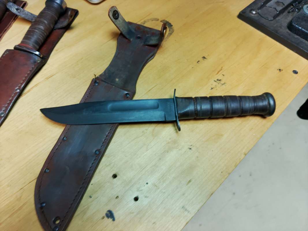

Hey all, here is a K-Bar Mk2 I brought back from a bad situation. Reinstalled and cleaned up the original handle, wasn't in very good shape. Reparkerized as well.
