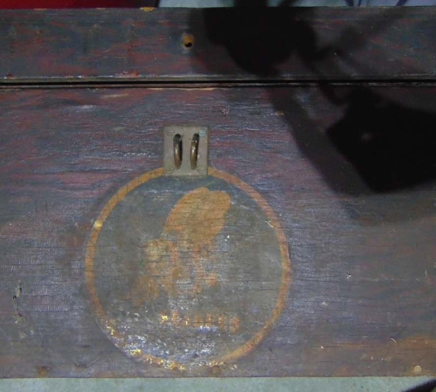

         As found on Nov. 10, 2023  the item suffered from a crazed, abused and  oxidized finish which darkened the entire surface including the decals and name. It had bottom rot which softened the wood below whatever had sat on it . Some nasty unknowns were stuck to the base inside.  Of course, mildew. The plywood was sprung and split at all corners. The lid’s rusty hinges were sprung due to splits around the brass screws. The top hasp was missing. Rusty nail points poked out at various places. The back inside rail fell off. The large decal in front had moisture damage to the bottom 25 %.  Small pieces just dropped off. It had rope handles on each side added after other handles were removed because,  I believe, they stuck out. So, then rope.   It was the best thing I had found in the year.

            Before tackling the outer surface the decals were carefully cleaned with Simple Green. The lid decal and paint was stable and withstood this well. The large decal on the front was quite fragile and could only be cleaned lightly. Even so, many small bits came loose and were lost. It was decided to clear coat the large  decal with polyurethane at this point to stabilize it before proceeding further. When dry the image was much improved. I might have used clear shellac but shellac can darken over time. On the other hand I have a humidor refinished in polyurethane in 1971 which is still exactly the same.
