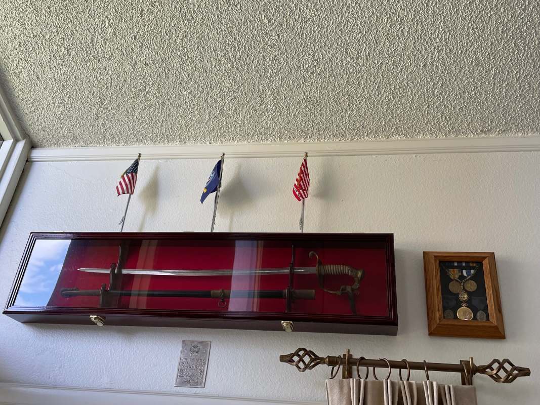

Was needing some advice please. I Have several US Naval swords all pre 41, and was wondering is there any Maintenace required for the leather scabbards?I live in Az where the humidy most of the yr is very low, haven't seen any issues yet, but want to preserve as long as possible. Thanks in advance, Jay

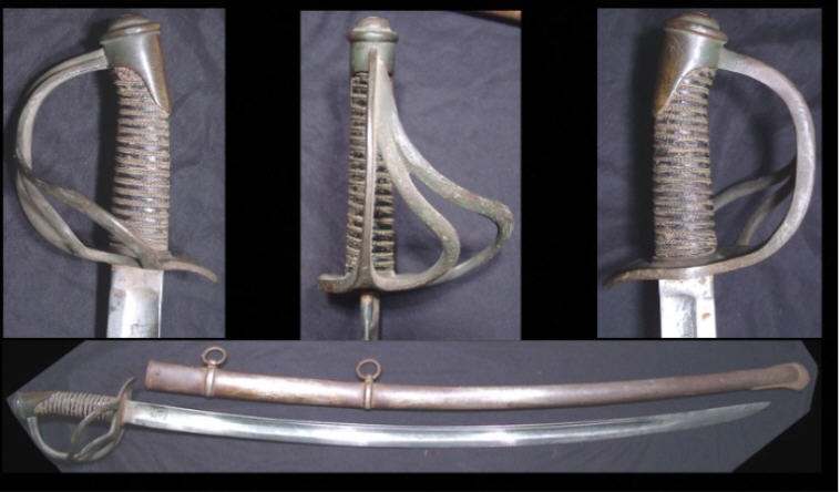

I have used Pecards antique on leather for about 15 years or so on various items  It is mostly white spirits and beeswax.  It does darken, it does penetrate.  I'd post em all but here are two.  A dead Western L-77 and 230 year old scabbard that was literally turning to red dust.  I've more treated with Pecards and have had great success.  One more, a desiccated sabre.
Cheers
GC
