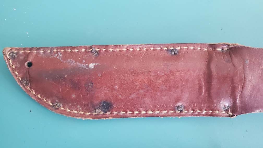

I inherited a couple of his knives which appear to be military issue and seem appropriate for his period and scope of service.  One is a PAL RH-36 and the other is a Camillus 1950’s Pilot Survival knife.  While I suspect they are USGI, each has a couple of characteristics that vary a bit from the similar knives I have researched on this forum.  He was an avid outdoorsman, so I would not be surprised if these are commercial copies of knives he would have seen while in the Navy, just as I would look for a close replacement for the Ka-Bar I carried while in the Marine Corps.
Both knives were stored for decades in a partially subterranean workshop and have been, unfortunately, quite neglected.  I really don’t care about their monetary value, I only want to clean them up as best as possible without harming them and preserve them in my collection as a reminder of him.  Basically, I want to do right by him and his knives.

How would one go about cleaning / treating the leather handles?  I have watched a few YouTube videos about saddle restoration and they recommend Scrubbing Bubbles Bathroom Cleaner to remove the mold – this seems like a radical approach for a knife and I am worried about damaging the leather rings.  I really have no interest in replacing the leather handles and prefer to stabilize the leather, remove the verdigiris and mold and keep as much of the original patina as possible.
I have read about using Hoppes for the verdigris – would that be the better general approach for the handles?
What treatment is best for the sheathes?
