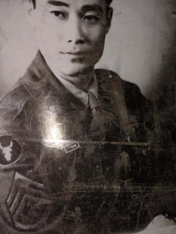

Anybody know how to keep a picture from falling apart?
Part of a grouping I was thinking about selling. It's just turning to dust. Not sure why, I have had it stored in a sealed pelican box for over 2 years. It wasn't in the best shape before but it's falling apart now. Any idea how to stop it?
If it's a very important picture to you, then a qualified paper conservator would probably be able to neutralize whatever is happening to it. Then encapsulate in some manner, a sleeve or the like, with a neutral pH stiffener backing for support.

I'd get a high-res scan of it while it is still visible, that's for sure.
An idea . . . a pelican box is plastic, I believe? Certain substances react to being kept confined in plastic enclosures, so it could be that whatever that picture was made with/developed on or with doesn't react well to being sealed in plastic. Plastic outgases, as well as the picture would be outgassing if in contact with certain substances. So, it could have been a bad blend, which you wouldn't really have  a way of knowing.

Yes, plastic box and I had it in a plastic sleeve inside a plastic bubble lined envelope. I didn't know plastic could hurt photos. This stinks. Scanning it sounds good and laminating it afterwards. First thing is first, all the photos are coming out of that box today. Thank you

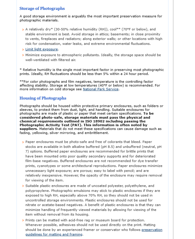

Here is a NICE TUTORIAL on safe photo storage from the
The Library of Congress > Preservation > Collections Care > Photographs

Your pelican case is more than likely lined in polyurethane foam. This foam, as with most petroleum products off gasses. Specifically, polyurethane foam is acidic and becomes more acidic as it breaks down. Effectively, your photo was exposed to acidic compounds and broke down. Some modern foams aren't as bad, but foams from the mid 90s and before are very bad, especially if they have been exposed to heat.
