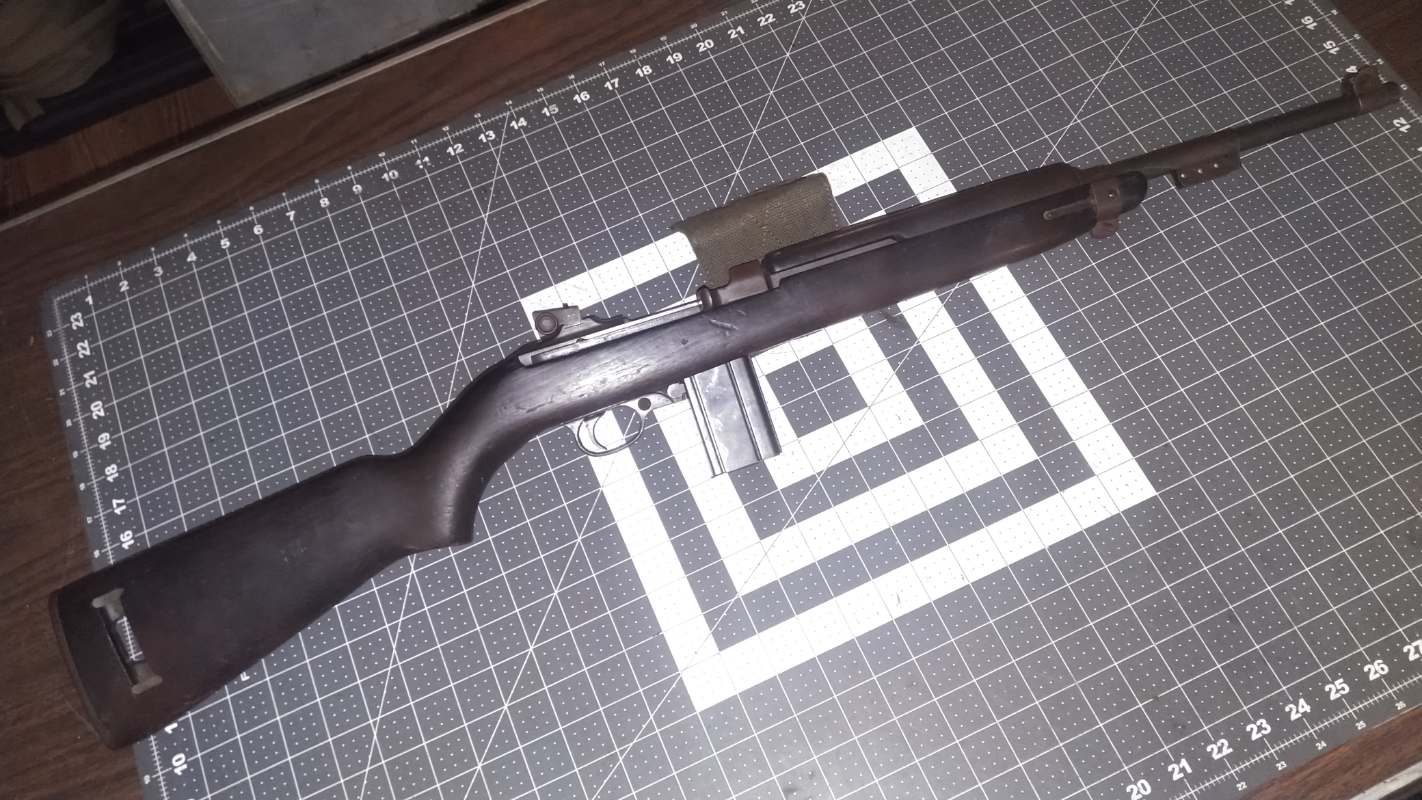

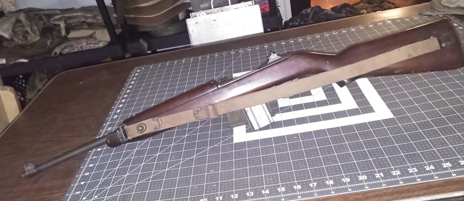

Not the best carbine and I'm sure it's not correct or matching but it was the first military one I picked up. I had a couple of universal carbines I picked up before this. At the time (about 2002-03 I think?) You could buy a universal at the flea market for $100-$150. You would see them a little higher but you about once a month or so one would pop up for well under $200. Think I paid $75 for my first one but it was poorly sporterized. I was perpetually broke so that's what I could afford. Anyway the point is the $300-$500 USGI carbines where outside my price range and although they did pop up cheaper than that I was never lucky enough to be there when they did. I found this one out there back around that time. I had just sold some bottles (I was digging old soda bottles and selling them at the time) and had some extra cash and the he wanted $350 for it but I only had $300. He was nice enough to take $300 and I picked up my first military M1 Carbine and went home broke... As usual haha. I wish I was more experienced back then. He told me his uncle or father brought it back from WW2. The sling and mag where with it when I got it so you're seeing it just like I picked it up. He mentioned what unit they were in and basically gave me the whole history on it but I wasn't paying very much attention. I was just wondering where I could find a bayonet lug for it and if I could find one of the cheap fake paratrooper stocks. Glad I never got around to destroying it but still pretty mad about not paying attention to him and writing down what he told me.
Just on the face of it, I’d bet you have an as issued carbine. That thing looks gorgeous. Hard to say for certain though with out it in hand. For the price you paid you did very well. If the internals check out and there’s no evidence of restoration I’d says it’s worth at least 2k. The slings looks original as well.

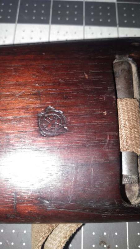

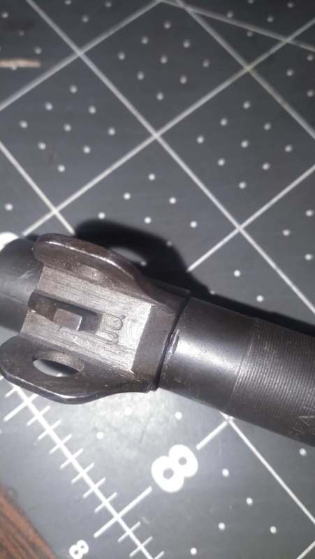

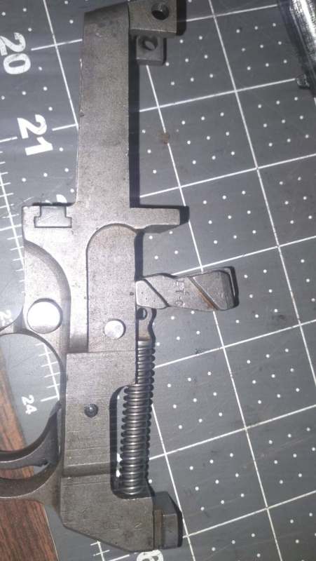

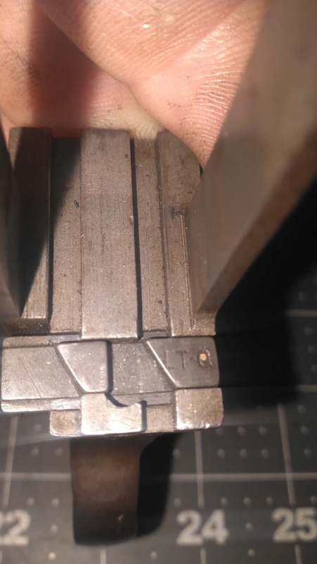

Here are all the markings I could find. A lot of them do not have a Q.
Wow, looks like you did good.  Whatever you do don't put a bayonet lug on it but hey it's your carbine but you will lower the value.   Looking forward to seeing it out of the stock

Looks like the slide and trigger housing, bolt are not Quality but thats easy to fix if you want,  Dog leg hammer is a plus.
How do the rear sight stake marks look and the barrel band impression inside the barrel channel on stock look?

I don't see any stake marks on the rear sight. Maybe under the spring?

As far as stake marks, from what I can see the sight looks good.  and the band marking on the stock is what you want to see.  Nice collector grade carbine,  Worth six times + what you paid. :)  Check on the back of your spring tube, I bet that has a Q on it.

Go over to the Carbine Club's website and also the forum.   Look at the data sheet used by the club and you'll get a sense of the the differences within the various parts.  As long as the parts interchanged, the manufacturer's differences between each other's parts and over time where all acceptable. All manufacturer's subcontracted parts, and traded parts.

The adjustable sights were usually held in position with a punch staking.   In theory the adjustable sight and the later barrel bands help accuracy, at least a little.

I would hesitate on replacing any parts right now. Many contractors swapped parts amongst each other. So it’s perfectly normal to find carbines with markings from different contractors. For example, my IBM has a NPM rear sight. In late 43 I believe NPM sent IBM 20,000 rear sights. If you have War Baby By Lary Ruth, there is info in that book on who shipped who parts during the war.  I do not have my book in hand but I can get to it this weekend.
