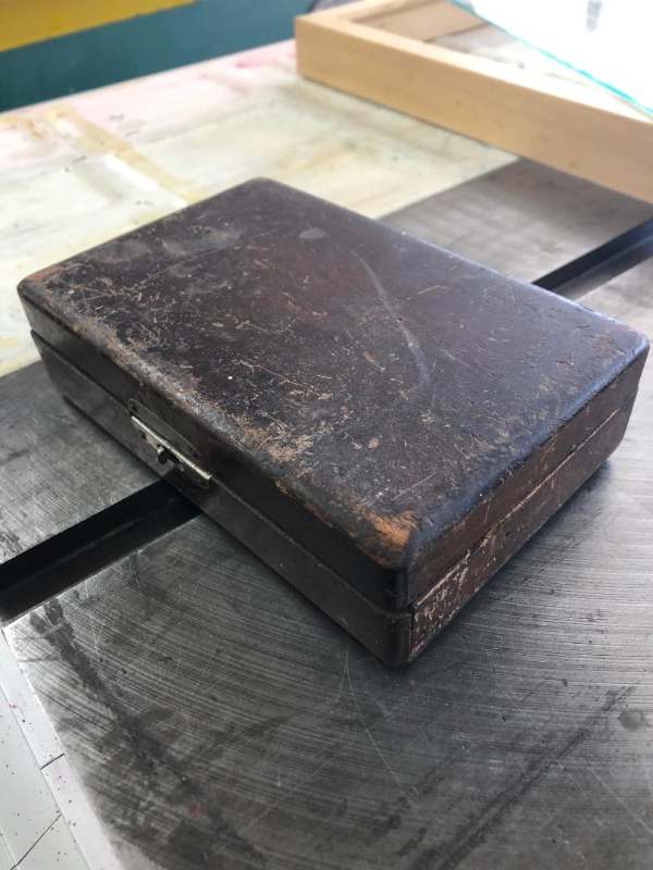

The mix is carnuba paste wax, boiled linseed oil, and, depending on the mood, some type of solvent. Toss a splash of naphtha or spirits in or leave that part out. It's super flexible. I stir it to look like wet peanut butter - almost dripping. Many, even furniture restorers, apply such mixtures with 0000 steel wool. I did that here but just use a rag if you are concerned with damage. The more solvent and the more you run with steel wool the more age you will remove(that gross, pasty, black goo in the corners). Rub it in pretty good either way but don't break through the original finish. It'll kind of soak in so I like to add another layer with my fingers or a rag and leave it kind of thick. Leave it for a few minutes - not critical. Buff off with a clean cloth... or a waxy cloth then a clean one... not super critical. It'll take on a luster and you'll buff until it isn't sticky or gooey feeling. Smoof!

I have this box that was originally from a '30s small crystal radio. Don't know where I got it but it was empty. Maybe one day I'll build there but it's been sitting out in the garage as well. Here's a before and after:
A lot better.
