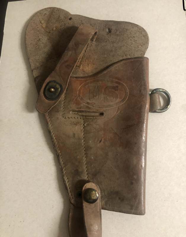

Suggestions on how to restore these holsters
Been busy these past few days but i wanted to finally pick up on some restoration projects i pushed to the side. I got these holsters back in November for 25$, i had made plans to restore them but school got me off track and i basically forgot about them until i found them buried in my web gear pile. What would be the best course of action to restore these holsters, all of them exhibit mold, and oxidation on the brass, also some of them are missing hardware and i’m wondering where i could get replacements. Also for anyone who is curious, they’re 43-44 Enger-Kress holsters.E0A0850C-C90F-44EB-90EE-F529E51F6942.jpeg.616d723e1a71e63f8c14d21e43977b41.jpeg1076DB3D-F909-429A-9DFC-1BDEA998797B.jpeg.547ee3262c411468e3b7681d7b38fd55.jpeg
I cleaned up some old leather this way: Wiped all the dust and dirt off with a wet rag. After it was clean, I rubbed/polished it with vaseline. Looked good, even after years. It didn't make the leather look like new, but it preserved it and was cleaner. Not sure what to do about the mold though.

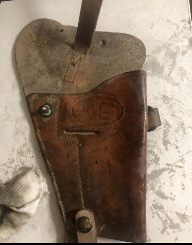

Thank you all for your advice. I’ve begun the restoration process for the holsters today, i picked out the grimiest and worst condition holster out of the lot as a sort of experiment piece for this whole project so if something goes wrong, i don’t ruin all of them. My first plan of action was to wipe it down with a rag, which seems to have done amazingly well and has seemed to clean it up very well which gives me hope that the others will clean up even better. This also brought out some previously unnoticed initials which was interesting, don’t know the provenience of these initials but i’m meaning more towards it being military-related as the seller stated these holsters never ended up being used and just sat in their garage or barn, don’t remember which as its been a while. Anyway i just wanted to provide a update to progress of the restoration of the holsters and i plan on doing more continually after i finish my restoration of a barnfind Talker helmet.19BA4E07-E84F-44DB-8EB8-B5625E4586D0.jpeg.c42b55196ff1e4ebcc6a714ed745a8e9.jpeg8FA19C74-1CEC-480A-B3E6-42F3918A90ED.jpeg.03a12d9f96080f304e3f6a94829c7dc4.jpeg3988CF3D-FB96-475E-A705-0C65AC9DCA6C.jpeg.b2de838beb8282e4e09d5b233f2d1649.jpegA3488625-AD5F-4D1A-B84E-8F9C0A2C28BB.jpeg.6e0462b83c806d9114811e7118d8440f.jpeg1FC2AF2B-99E6-4C2E-8B3A-878E3B35E290.jpeg.4c32a902162a1b05e058c5830d6980b5.jpeg
