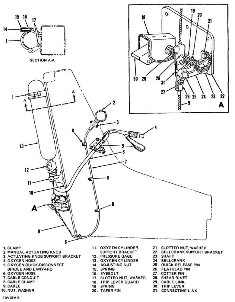

More detailed breakdown from the J5D seat Mx manual. Good breakdown showing the mechanism that the pull cable connects to allowing the automatic activation with the trip lever (item 30) and the manual activation cable (item 9) running up to the green apple (item 2)

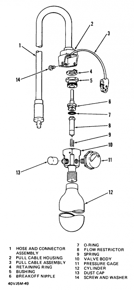

Breakdown of the bottle and its valve assembly.

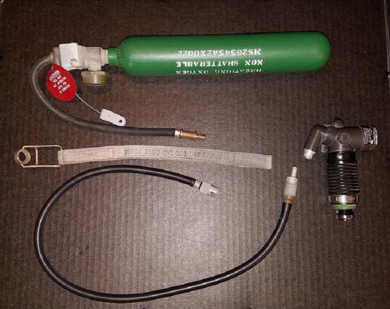

Showing the various components and the CRU-60 oxygen block that it attaches to. This bottle still shows its charged and has the safety pin that would be removed before installation. The pull cable only requires 1/4" pull to activate it so that pin is a must currently. Also note the quick disconnect lanyard PN has OV1 in it showing its end use is specifically for the OV-1 Mohawk.
