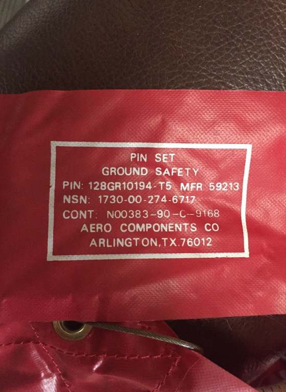

This might not be of interest to most, but I ran across these the other day at a surplus store.
These are Ejection seat pins for the A-6 Intruder. Martin-Baker GRU-7 set of seat safety pins. Seven pins used to "safe" the seat when the aircraft is not flying. I was once a A-6 Plane Captain and had to safe the seats after every recovery, so I immediately recognized the pins at the surplus store.
Anyway here are some pics of this nice un-issued set. The store had more available, but I only purchased one set.

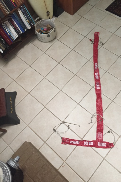

A couple more pics.

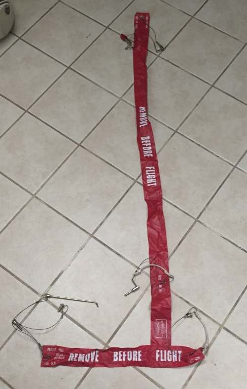

What was the going rate for those safety locks at a store? Here are pics of my safety lock for the Grumman OV-1 Mohawks Mk-J5D ejection seats. What are all the pins labeled on the A-6 set? These for the J5D seat have 7 pins: Ejection Gun, Face Curtain, Drogue Gun, Rocket (TCR) on the left side and the right side has Bucket Pin, Manual Override and Secondary Firing Handle. The earlier version of these from the Nam era with only 5 pins were setup exactly like your A-6 assembly in the L shape. The old Mk-J5 and J5B seats for the Mohawk had 2 less pins, lacked the Bucket Pin and the TCR Rocket pin.
#11
Here is the tag showing the 3 digit Grumman Aircraft model number 134 for the OV-1 like the A-6 is shown as 128

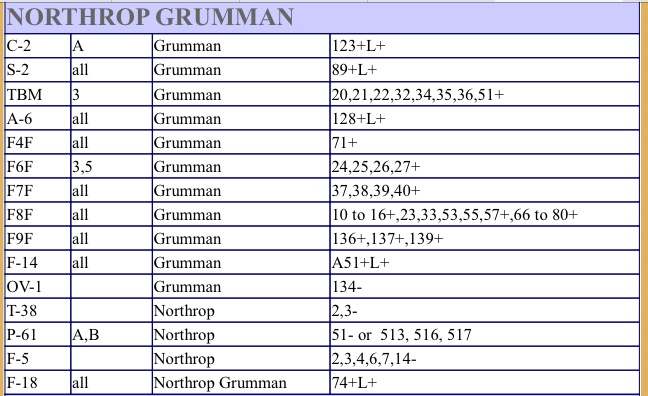

#23
I am confused, I dont remember the 303 numbers used on the F-14. The usual numbers for the F-14A is the A51 prefix.
Here is a screen shot of the prefixes used by Grumman. Not sure what the 303 numbers are used for.
#25
Id guess if you have a correct NATOPS manual covering the Maintenance of Illustrated Parts for the actual GRU-7 seat used in the F-14, it would show the correct Grumman part number for the Ground Safety Lock.
