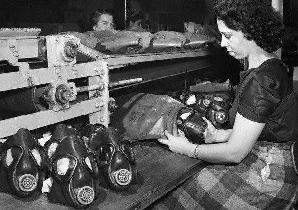

Ken, what's the date and story on that picture? That's the first time I've seen a UL marked bag in a period photo.
Hey,
I couldn't find a date but I recall learning that the M-5 assault gas mask was only made in 1944. The production was discontinued late in 1944 because of problems with the rubber, apparently it was not as resistant to cold temperatures and moisture as the army had hoped. So I'll go out on a limb and date it 1944.
Would be nice to know what factory the picture was taken in but unfortunately, there's no additional info, at least not where I found it.
