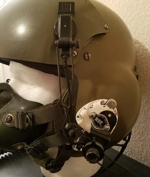

I have a 80s era SPH-4 helmet that was modified for use with the cut-away face plate type AN/PVS-5 NVGs. The surgical tubing that wrapped around the helmet is toast so that will need to be replaced at some point. I decided to show a rather uncommon (in the Army at least) oxygen mask setup, mounting a MBU-5/P Quick-Don mask with the SPH-4. This was in fact done in the Army by some fixed wing aviators and also available for rotary wing use if a O2 system was installed. It is shown in the 1984 dated Army FM 1-302 with a SPH-4, but the QD MBU-5s were more commonly used in the USAF with the H-157 type headsets. When headset worn, a special head harness that mounted to the headset was used that had the snaps for the mask to attach to. The SPH-4 series helmets had O2 mask snaps mounted above the chin straps on the ear cup retention assembly. A special wiring harness is on the quick-don assembly which is a unique feature of the setup. When the setup is worn, the boom mics wire is unplugged from the headset jack on the rear of the helmet or headset. The cord on the mask has a Y split with a mic plug and a mic jack, the mic plug is plugged into the helmet or headsets headset jack and then the boom mics cord is plugged into that jack on the masks cord. This allows both mics to be plugged in but the way the system on the mask is wired up allows only one mic to be hot. When the mask is in the donned position, the mask mic is hot and the boom cold, then when they mask is released by pulling the black knob this disconnects the mask mic and makes the boom mic hot again. The mask when not worn will hang at your chest.
Mask lowered:
Cord setup showing the Y split going to the helmets headset jack and the boom mics cord plugged in:

Yeah the SPH-4 from its start in 1969 had snaps located on that ear cup retention assembly. The 69-76 retention assemblies had 4 snaps attached over leather strips, bottom 2 were for the chin strap as they had removable snap on chin straps and the top 2 snaps for O2 mask mounting. The 78 through the 80s dated helmets had a new more crash worthy non removable chin strap setup but still had 2 snaps on each side above the chin strap for O2 mounting. Some replacement ear cup retention assemblies in the late 80s and early 90s actually didn't have the snaps for the O2 masks. By that time it was already common practice to have the Cast O2 mask receivers mounted to the shell and using T or J bayonets on the masks, no more snap strap kits. Three types of snap mounting could be used with the SPH-4, the early hook setup like WW2 and Korea era masks had with the metal snap on hook retention (not sure what the actual technical term is on those), then the MS-22001 and MBU-5 masks had snap on strap retention setups, or this Quick Don snap on setup. I'll post some pics of the other snap retention setups and then probably follow up the SPH-4 using bayonet receivers.
