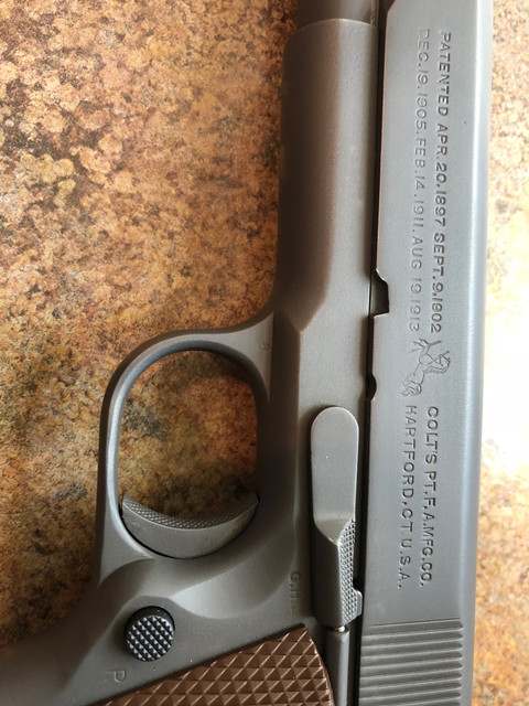

Here she is.

Is that the original finish?
#13
I was going to also say-- its a refinished piece. front sight may have been changed???
#14
Far from it sadly.
This finish is relatively recent, and is a zinc phosphate finish, which is what causes the light gray color.
This should be done in a manganese phosphate, which yields a darker color; which when immediately subjected to cosmoline, resulted in the greenish finish. Ive never seen a modern refinisher get the USGI 1911 Parkerization right. Some are closer than others, but none 100%. Even if they do get the color close, there were certain stamps and markings that were applied after finish. So, when viewed under magnification, will have bare or burnished metal on the vertical structures of the markings.

She is actually a Bubba save. When I got her she was coated in duracoat and it turns out was also nickeled under that. Friend of mine removed both modern finishes and parkerized in zinc. Had another barrel in it but came with the original Colt barrel. Replaced the springs and pins and I now have a factory matching but refinished Colt for just at $800 total invested.
