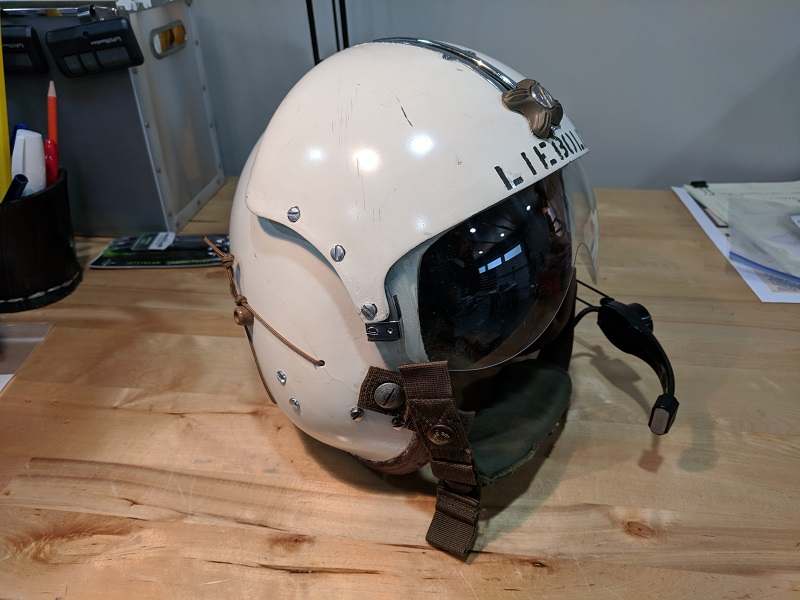

Thanks to 72PSB, I was able to find the parts I needed and I reassembled Dad's old APH-5 today.
Thanks Bob!
I have one question:
The visor itself seems to fit perfectly, but apparently I don't know where or how to assemble the copper/brass spring clip. It was getting in the way.
Does anyone know exactly how this is supposed to be mounted? And is there supposed to be one on each side? (I only have one.)
#9
Here are a few shots of the assembled helmet!
#10
Thanks Bob!
If I recall, the clip is located on the middle visor screw, under the visor with the end tip pointed towards the visor. It helps keep the visor from binding up in the track...

A tip in case it helps anyone else: The pictures above show a replacement visor I found on ebay. The original visor has a rubber strip on the bottom edge, to protect the pilots face from the possibly sharp edge of the visor. I found I was able to remove the rubber strip from the original visor by gently pulling it away. I installed the rubber strip on the new visor with Weldwood contact cement. The cement was very messy, but after it dried it was easy to cleanup the mess with Xylene. The Xylene did not damage the visor at all.
#20
Now on display with rubber trimmed visor.
