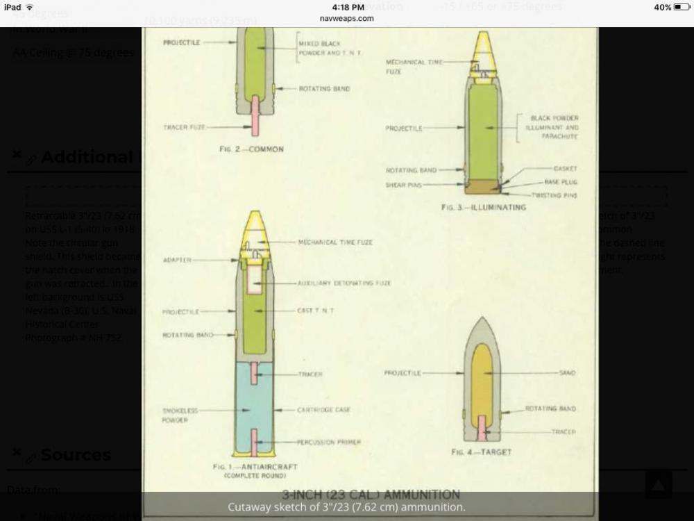

I finally got this image to post. I found it on the NavWeapons website. Identified as a 3"/23 TP round. For some reason the entire chart did not go through, see Fig 4, yours? I suspect so, it says the interior was filled with sand. Now it is up to you to research what type of artillery pieces they were used in. BOCN experts are still commenting, they have all sorts of the Company information, but no positive ID yet.
