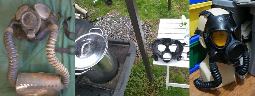

Chloroprene (Neoprene) is very stable and tolerant of most conditions. It does have similar properties to NRL in that over time it releases curing agents when exposed to the elements, but it doesn't typically rot the same way. What it will do is harden, and I've only found one way to reverse hardening of neoprene, which is to boil it, preferably with a dash of methyl salicylate (wintergreen oil) mixed in, but I've had mixed results with testing, the process with wintergreen oil attacks and dissolves adhesives, and may damage plastics as well (I've always disassembled test masks before boiling so I'm not sure of this). Not to mention the rejuvination causes the rubber to swell and expand causing the parts to loosely fit back together and the residual wintergreen oil evaporating off the rubber will stink up your entire house. I don't reccommend doing more than a silicone treatment and if absolutely necessary, a plain water boil to soften neoprene into a displayable state. It typically takes until the rubber is rock solid for it to begin cracking, though.
Pictured below: A 'Barn-Fresh' July 1944-Dated Navy Diaphragm Mk.IV Gas Mask (Neoprene) which I have restored to a flexible condition with methods decribed above.

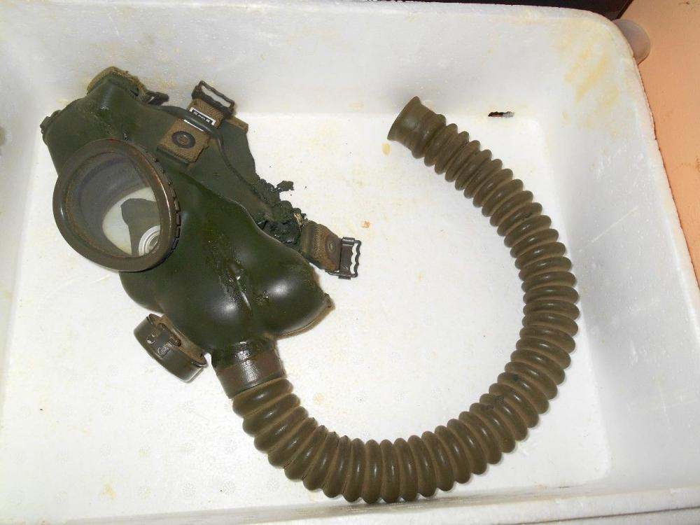

Also, in case anyone didn't believe me about the plastic bags causing masks to melt I mentioned earlier. Here we have a Japanese JSDF Type 1 Protective Mask (A copy of the U.S. M3-10A1-6) owned by a Polish collector I know, who was shocked to discover this gooey mess after he had left it stored (in a temperature-stable room, mind you) in a polystyrene box stuffed with plastic container as a face form after the course of a couple months. It's just not a good idea to bring natural rubber into contact with cheap plastic for storage.
