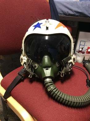

Just Found a VA-176 Hgu-33
I have now done a bit of work to it, but still more to do.
Some more pictures.

Looks like you need the comm wire for the mask. What else?

When I first got it I had to do a bit of work to it. The visor housing had a very large crack right at the bottom, the rails that the visor runs on were damaged and needed to be replaced, and there was no visor knob. Also the helmet was quite grimy and I had to do some cleaning. All what is left to fix as of now is to get the AM7607 block and the communication wire for the mask. In the future I might look into replacing some of the earcup foam as it is deteriorating, but the foam is still holding together for now.

Status Update:
Found the proper amplifier block and mask cord. Now I just need to figure out how to attach a keeper to the bottom of the wire.

You would need the elastrator tool to get the keepers together without ripping them unless someone has come up with a creative way to stretch em out. That tool is pretty much an off the shelf farm tool used for docking?castrating animals. I don't know what Gentex or Scott would have charged for one but I picked up a cheap one for 7 bucks that was from a Farm Supply place, works great. Has 4 prongs that when you squeeze the grips it pulls all 4 prongs away equally without stressing the silicone keepers both on the wide hose part and the cable portion. Makes the job pretty easy to slip the plugs through.

Got both the Amp and the cable from FlightHelmet.com. Just a heads up though, all what they have left in terms of Amps are the ones in "excellent condition" and will run you 125$. Luckily, I got my Amp before they ran out of the lower priced ones.
