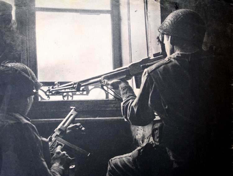

IIRC, there is a picture of an airborne infantry squad in ETO with an Asian-American BAR gunner but I can not find it.
I know that one platoon of B /502 had BARs in an equipment bundle for the Normandy operation. Lt. Brandenberger retrieved said weapon and used it until he could find a replacement Thompson SMG as his was lost on the drop. Hope this helps I don't think that they were a TO&E weapon for the parachute infantry troopers,but they were procured and used as photos prove. The photo of the 101st troops in 43s is 327th glider which did have BARs on the TO&E. Best Paul

this is two other interesting pics illustrating BAR utilization in the 17th AB :
The first one shows Staff Sgt George H LOSS (466th PFAB) firing with a BAR during the Battle of the Bulge.
The second one was realized on early March 24, 1945 just before the take off for Varsity.
Richard
