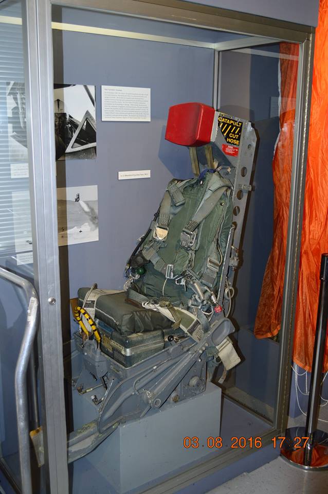

If someone visits Pima air museum, can he/she take some detailed images of the seat they have on display? (with the SR-71 pilot in it)
Thanks!
Ron
#7
I looked through the pics from my last visit to Pima and only have this terrible blocked partial view but it does seem to match the sheetmetal stamping shape on the front lower portions. You can probably match up some more features if you compare to your seat from the side. Next time I go I will get you some better shots without tourists in the way. Sorry was not focused on the seat that visit.
Regards,
Frank
#8
Regards,
Frank
HI Frank,
That's indeed the same kind of seat. I noticed it still having some of the parts mine is missing (they look professionally removed upon changing this seat type for the SR-1) These parts are likely the same as on most other (older) C-2 ejection seats, like the ones used in the German Luftwaffe before switching to Martin Baker seats.
in the image attached you find 3 versions of the C-2 family I have. SR-2 from Jordanian F-104B, the modified C-2 from the Blackbird and in the back a C-2 from a Dutch F-104G.
Would be great to see images!
Thanks,
Ron

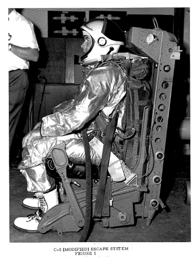

Hi,
After reading around 1120 pages of (de)classified CIA material on the A-12 Oxcart, I have learned the following.
My seat was modified (after a crash in '67, when a pilot got stuck after ejection)
In the reports the life support units talk about: "Modified C-2 Rocket-Catapult Upward" and F-104 rocket type.
Seems the seat never got his own designation, the K-1 Ken Collins was talking about, seems to have been a pressure helmet type.
Also learned from the reports is that the seat kit/container was of the "MD-1 type" in my opinion a modified version then.

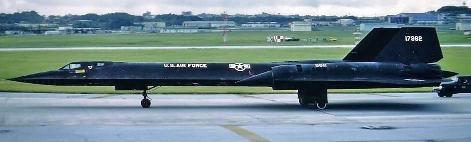

#17
Finaly an update on the ejection seat!
As can be seen on the image of the backrest, a faint number ending in 013 is visible.
Further inspection and some books by Paul Crickmore, learned that the first digit was not a 9 but a 2.
This making 2013, being article #2013 / 61-7962.
First flight was made on 29 Apr 1966 by Lockheed Test Pilot/RSO: Bill Weaver/ Steven Belgau.
On 28 July 1976, SR-71 serial number 61-7962, piloted by then Captain Robert Helt, broke the world record: an "absolute altitude record" of 85,069 feet (25,929 m).
Several aircraft have exceeded this altitude in zoom climbs, but not in sustained flight.
On 21 January 1990 it was the last SR-71 that left Kadena AB in Japan.
The aiframe now resides in Duxford (UK), the seat was switched somewhere around 1968 for the SR-1 type.
Cheers
Ron

Much appreciated! I put together a timeline for this airframe. Information taken from several sources.
Timeline “article 2013” / #962 / 61-7962
SR-71A 61-7962 - 2835.9 flight hours
29 Apr 1966 First flight SR-71A #962; Lockheed Test Pilot/RSO: Bill Weaver/ Steven Belgau
24 May 1966 SR-71A #962 Delivered to Beale AFB, CA, by USAF Crew: Douglas Nelson/ Russell Lewis, from Palmdale, CA
Sep 1968 Switched OL-8s Kadena Japan, SR-71s #974,#976,#978 with #962, #970, #980
28 Jul 1976 SR-71A #962 set an Altitude World Record of 85,068.997 ft, USAF Pilot/RSO: Bob Helt/Larry Elliott
6 Sep 1976 SR-71A SN 61-7962 arrived at DET 4. of the 9th SRW at Mildenhall, UK for a 12 day deployment.
7 sep 1976 61-7962 flew her first successful operational mission from DET 4 and performed a complete surveillance of the Barents Sea area with Pilot Richard Graham and RSO Don Emmons at the controls.
Moved on to DET 1 (Kadena, Japan)
1 jul 1980 from Kadena AB to Diego Garcia test facility with Pilot Bob Crowder and RSO Don Emmons at the controls.
To Beale AFB, sometime during her life at Beale AFB, she wore a unique skull & crossbones emblem and she was also seen with “Snoopy” asleep on top of his doghouse and at one point also had "Speedy Gonzales" Arriba...Arriba and Numero Uno stencilled.
8 Aug 1985 SR barns at RAF Mildenhall used for the first time by SR-71A #962
21 Jan 1990 Last SR-71 #962 left Kadena AB(Det 1) for Beale AFB, at 0500, Tail art: A tombstone which read: "Det 1 RIP 1968-1990"
14 Feb 1990 Last flight of SR-71As #962 & #967, Beale AFB to Palmdale, CA, #962 was placed in flyable storage at AF Plant 2;
2001 After 11 years in storage at Lockheed's facility in Palmdale, California, SR-71 64-17962, acquired by the Imperial War Museum, was dismantled by a crew from Worldwide Aircraft Recovery before transport to Houston and onward sea-transit to Tilbury Docks en route for Duxford. A paperwork delay, and heavy snowstorms in the desert, have held up the move, but planned move the Mach 3 reconnaissance jet to Duxford in time for Easter 2001.
5 Apr 2001 arrival of #962 at Duxford IWM.
11 Apr 2001 #962 first time on public display at Duxford IWM.
27 Sep 2002, she was moved from her temporary location next to the Concorde, to the American War Museum hangar.

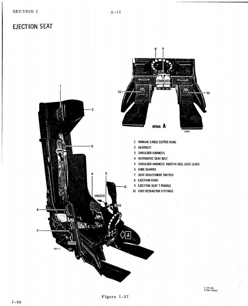

To bring it back on topic, some more information on the seat:
The part number of the A-12 seat started with an “AQ”, and the part number of the SR-71 seat started with a “4AQ”
As can be seen on the below image, the seat is identified on that image as C-2 modified.
#21
Some more images (taken from the CIA files) dealing with this seat.
