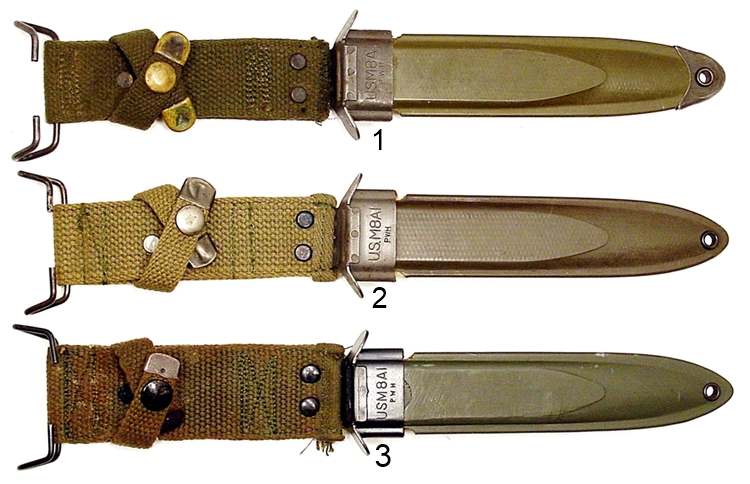

Chas was kind enough to allow me to have one of the scabbards for my reference collection. I do appreciate the opportunity to examine these odd items carefully. I can say that it is definitely more "modern" made, probably for the commercial market, but it is not impossible that it was made by some company for sale to a non-US military customer.
I have attached a couple of photos. In the first one, the top is a standard PWH (#1), the middle is an odd one I have had for several years (#2) and the bottom is the one under discussion. (#3).
Although #2 and #3 share some similarities, they are not identical. Some of the differences from the standard are:
1. The wire used in the double hook is slightly thinner.
2. The tips of the handle retaining strap are slightly more "Square" and are made of a metal (possibly aluminum) rather than brass.
3. The retaining strap snap fasteners are made of a metal other than brass, again possibly an aluminum alloy or may be nickeled.
4. The strap fasteners are made by companies that I have not found on regular issue scabbards. Most issue PWH used either RAU (most common) or DOT snaps. # 2 has THREE BELLS (inside the female fastener) and #3 has KOH-I-NOOR (on the male fastener). I have found no information on any company using THREE BELLS as a brand name.
See photo 3.
5. The hanger material on 2 and 3 is noticeably "softer" than is found on normal contract pieces. The weave is looser and seems to be slightly thinner.
6. The colors are different on all three hangers. 2 is much lighter and 3 is somewhat lighter than standard.
7. The hanger on #3 is distinctly wider than on 1 and 2. US standard is 1.50" +/- and #3 is about 1.75".
8. The rivets holding the hanger strap to the body on #3 are domed and hollow backed. US standard is flat head and solid back.
9. The throat markings on 1 and 2 are very similar - #2 may actually be an original PWH throat. The markings on #3 are similar to the wide PWH except the center V of the M in M8A1 comes down further than the issue version. (Photo 2)
10. The metal finish on 1 and 2 appear to be standard zinc Parkerizing. #3 is an unknown smoother and darker finish.
11. The bodies on 1 and 2 are both standard appearing cotton duck reinforced plastic, while 3 is smooth injection molded plastic. The smooth plastic is found on most of the later European (mostly German) production.
12. The tips of #2 and #3 have grommets in the tie down hole. The metal reinforcement tip was standard for all production post 1956.
