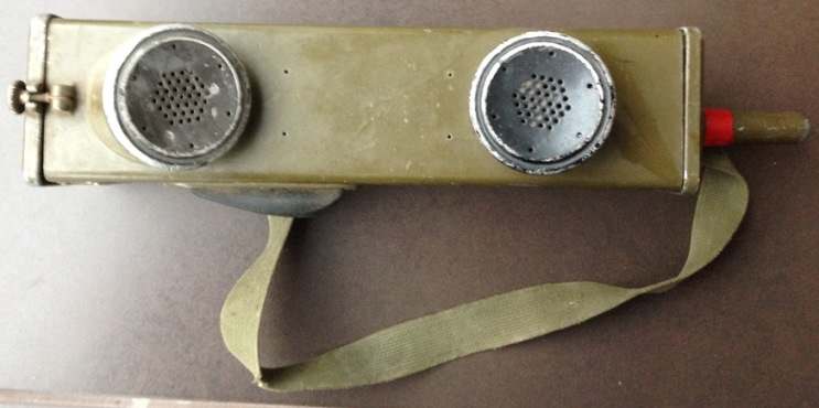

Hi all,
I got this walkie talkie SCR-536, also named BC-611.
Unfortunately, the label has been removed so that I do not have more information about this item.
Is it possible to get any more information about this particular part somewhere else? Particularly whether it is US made or not or WW2 or later...
I haven't dared to disassemble it yet and would like to know if it would be worth it...
Thanks for your support!
Philipp
It appears to be a BC-611 C, D, E or an early F model. The A and B had Bakelite rings around the mouth and ear piece, and the later F model has a larger bottom cap. If you open the bottom cap the markings inside should be in English.

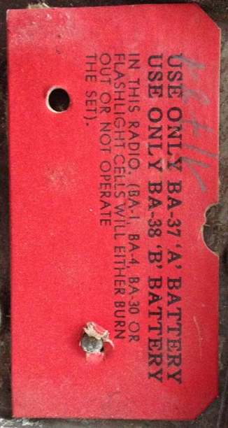

Thank you Robinb!
I opened the top and the bottom cap. in the bottom cap I found the attached red label which is in English. Hence, I assume US provenience.
Under the top cap I got to see some components. It looks like one of it is labelled with the "June 08 '44". Hence I assume that this Handy Talkie was issued in WW2 era.
Am I correct with my assumptions?
Thanks
Philipp

#6
The French made these after the war.
#7
The French 611s have three screws to attach the top lid, where as the WW2 US 611s have one screw.
#8
Hi BC312,
You made me happy (see attachment) :D
Thanks
Philipp
#9
If you unscrew the black ear/mouth pieces, you may find dates on the speaker/receiver components inside there too.
Cheers,
Glen.
