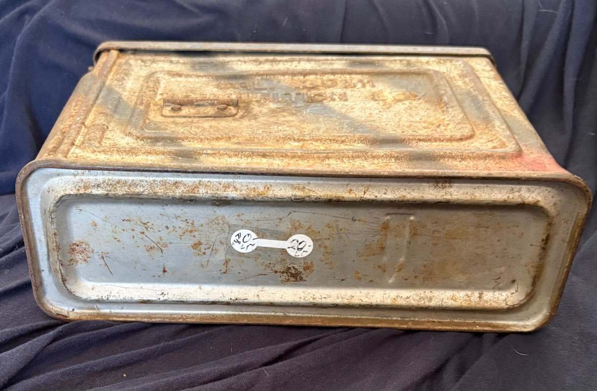

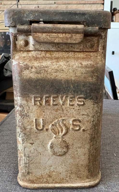

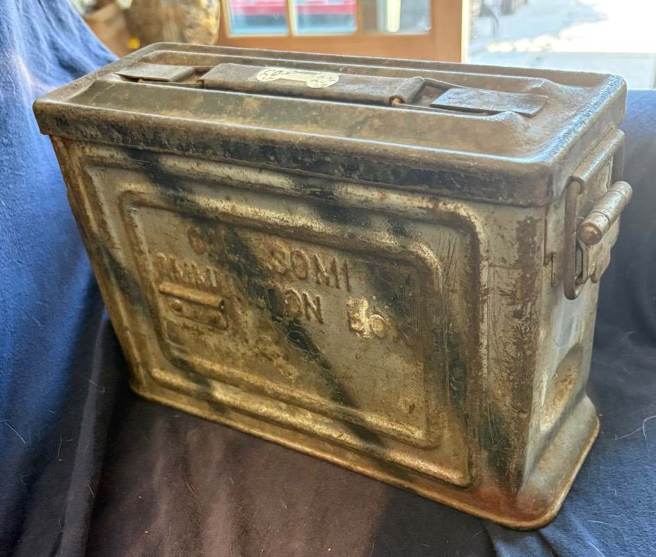

I poked around my favorite antique shop and came away with these two items.
The Reeves .30 cal ammo can has a very interesting paint job. I don’t see any evidence of any OD paint underneath the silverish and black paint scheme. Even the inside is painted flat black. I actually think it’s pretty cool looking. Have any of you seen anything painted like this? My guess is that it is a very rare US Marine Corps parachutist can that was used on submarines on D-Day.

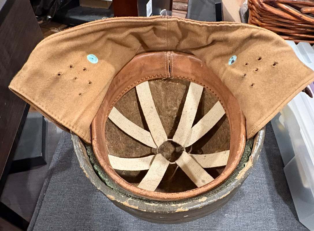

The other thing isn’t US but may be of interest here so I’ll squeak it in here. It’s an early war type first pattern British dispatch rider helmet. It needs a little gentle work but it is in nice shape. Unfortunately there are no markings. Now I just need a WWII British motorcycle to go with it. Gee, I’m sure glad I’m no longer actively collecting anymore 😁

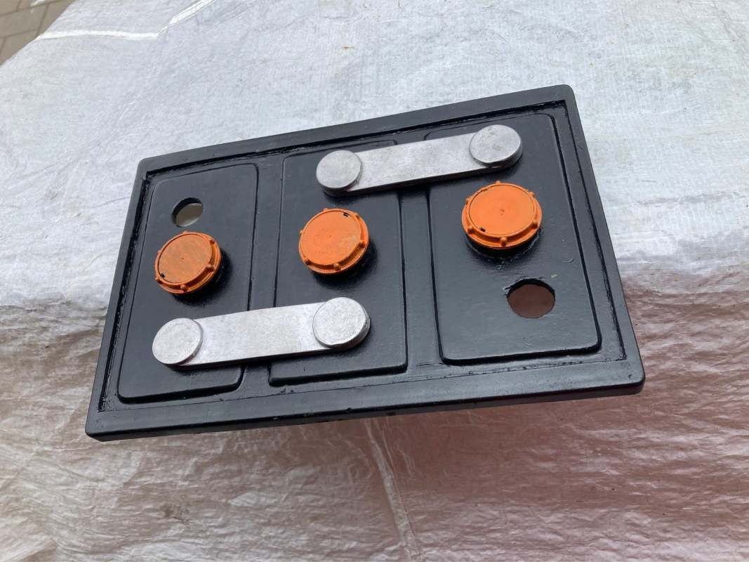

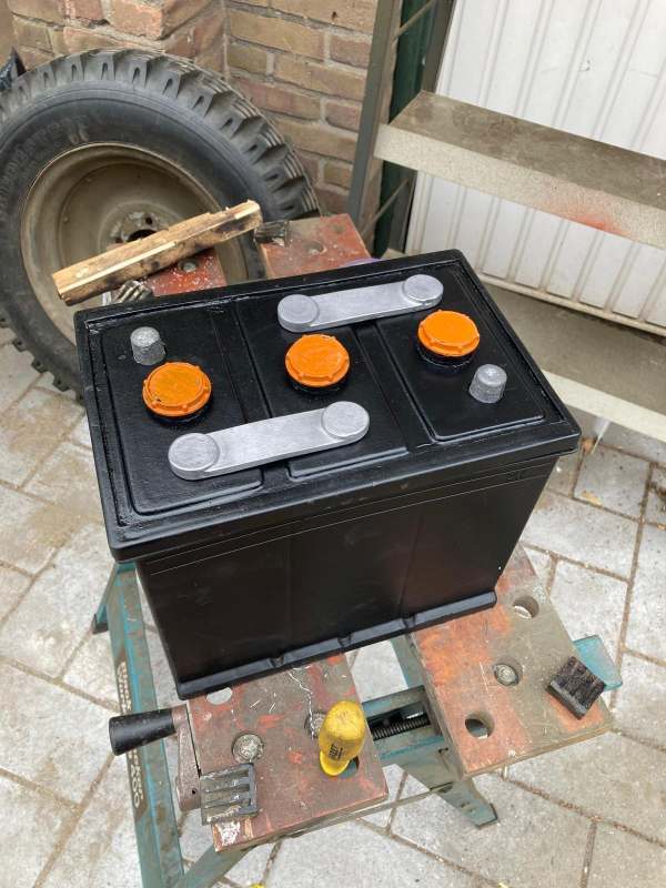

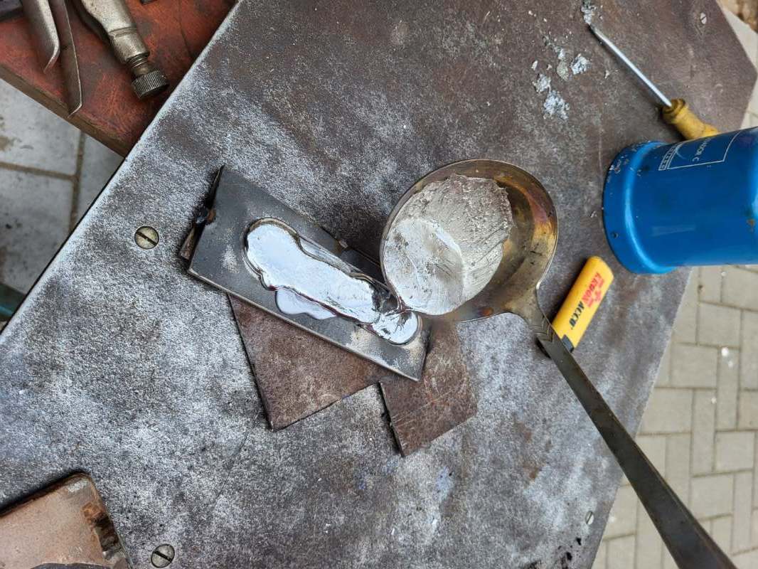

We worked on the jeep again, and most of last Saturday was spent working on the battery cover, which is almost finished now.

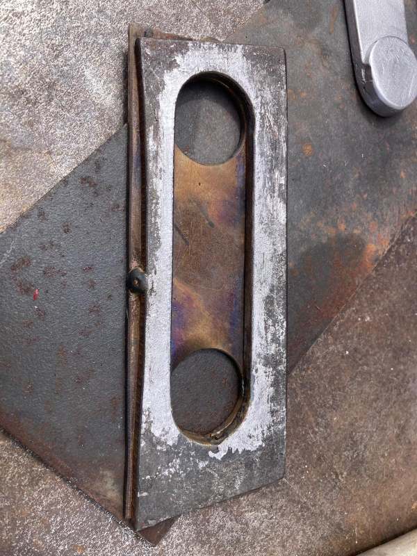

Original batteries have two lead bridges on top to connect the three 2V cells into a single 6V unit. Looking at photos, these lead bridges are basically a strip with rounded edges and a circular raised area at each end. I had some lead that had come out of the dead battery when I emptied it, and we decided to try and use that to make the bridges. So we constructed a mold from two pieces of thick steel sheet and a bottom piece.
We tried to melt some lead in an old soup ladle with a standard plumber's torch, which was actually pretty easy and after scooping off the contaminants that floated to the surface we poured the molten lead in the mold, which was also pre-heated with the torch. It turned out it was quite hard to pour the exact amount needed in the mold, so we took the cast piece out of the mold after it cooled a bit, melted it again and this time after pouring we used a scraper to get a straight surface. Again this was pretty easy by using the torch.
The result was even better than we had hoped for. After cooling the mold in water I used a vice and a socket to carefully press the bridge from the mold. This is the result; the top one has been cleaned but the bottom one is as it came out of the mold. As you can see it barely needs cleaning.
And here are the two bridges, made of actual lead, screwed through the underside to the fake top of the battery. I have painted the three screw caps orange, although I'm not sure if that is the correct colour as they might have been red. Anyway, they will require a few more coats of paint, but after that I think this side-quest is finished and attention can return to the jeep itself. 😊
I think it is good to do little side projects like these now and then to keep the work a bit varied, especially at times with less-visible progress.

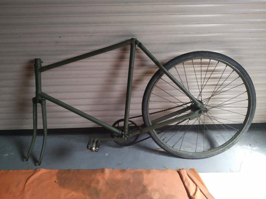

I've partially disassembled my 1939-1942 Mk.V bicycle to strip off the 15, or so, layers of ABL green paint. Will be sanding down the parts over the next few days.
Got 4 rattle cans of VW Bulli Green ready to go. It is slightly darker shade than what's on it now. But very close.
Also acquired a couple of modern and old stock parts.
Need to replace both mudguards, and make/find the mudguard stays of the right length.
Still need to source the correct style handlebars and Mk.IV carrier rack to turn it into a passable Mk.V
Found a Lucas Silver King lantern and a lamp bracket for it.
Hunting for a Brooks frame tool pouch (got a Soviet stand-in one for now).

Now that is being creative! Well done!

I've never been able to date my Mk.V bicycle, it has frame number T58600 and has no post-war ABL stampings.
Fenders are not original but with some tweaks can be used till I get some originals, and I have some usable (non-original) wheels. This project is put on hold for working on the jeep though.

Hi earlymb,
I have to say that that looks great, sometimes these self-made items don't turn out well but that looks almost original and factory quality, I don't think most people looking under your hood will give that a second look, as it look like what should be sat there.
