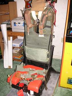

I have seen that ejection seats have been drawing some interest so I thought I would exhibit one of two MkJ5B ejection seats that I own, although this one has a prospective buyer I am just waiting to hear from about delivery. This seat has been sitting in storage for six or seven years as I have not gotten around to breaking it down, cleaning it up and putting all the 100% correct parts on it. As is it's just thrown together to keep the parts in one place. The other seat is 100% finished and I'll see about photos of it later.
IH
Front view
Left side
Right side
Rear with ejection gun in place.

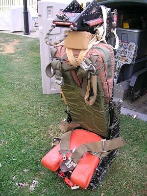

This is my fully restored MkJ5B seat. The parachute is packed and the drogue chute is packed. The seat raise mechanism works. The leg restraints have the white and blue garters attached. It has the number 883 painted on the back plate under the parachute which comes back to an OV-1C, 66-18883. This airframe was scrapped in 1972. Considering the seat was rough when I got it and it came from Arizona it seems likely it came from that airframe. Only way to prove it for sure would be to find maintenance records that show that serial numbered seat being installed in that airframe. I'm not that keen to go that far.

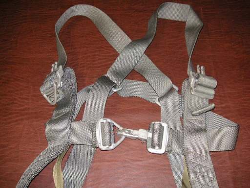

Here is a pic of the my OV-1 quick fit harness as setup in the fully restored seat with the RJE fittings on the risers:
The brown straps are the vertical restraint straps. The metal tabs on them fit around the female side of the seats lap belt, and a small survival kit retention lanyard on the lap belt also clips to the left hand metal tab. The early MA-2 harness had these straps from what the pic in the -10 shows.

The harness you show could be used with the restored seat but it doesn't look like it has the lower RJE fitting, it would require the chest straps to help retain the seat kit. The quick fit harness shown in the -10 or one like it with fittings arrangement would work with it. Your book shows two harness's, the MA-2 torso would not work as it does not appear to have the lower RJE fittings or chest straps. You can see one of the lower RJE fittings on the left thigh support of the restored seat. They are attached directly to the seat kit with a nylon strap. The Quick Fit harness has RJE fittings both at the shoulder and at the waist, and no chest straps. Both of the seats have the RJE fittings at the waist/leg position. A "mish/mish" harness like the one I have would allow for a "borrowed" Navy parachute to be used with a MkJ5B seat. Altogether, these things evolved through different variations which would normally be accounted for by appending the appropriate manuals with T.O. changes. Through use, certain features always turn out to be cumbersome, like the brown chest straps that helped link the seat kit to the harness. Using the lower fittings like the RJE fitting could seem to be more streamlined and the need for the chest straps ( fumbly things) could be eliminated. Evolutions are not always well documented, especially in times of war. The US Army created a quick approval system for needed changes through ACTIV and AMMC offices in the theatre. The documentation could be introduced locally very quickly and could have taken time to be implemented in other areas.
The harness you show seems to predate the seat kit version that are on the seats I have, it doesn't appear to have the RJE fittings at the waist/leg. It doesn't match either of the two harness's shown in the book. This is an illustration of evolution that doesn't get documented, at least in the book you possess. The harness I have doesn't match the book either. ALSE shops have proven to be quite adept at producing interim hardware when needed.

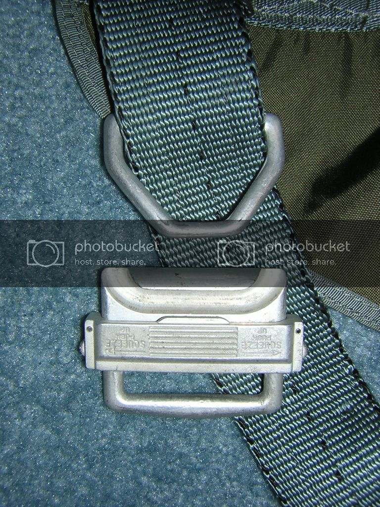

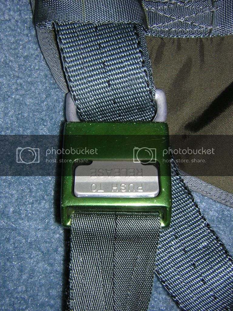

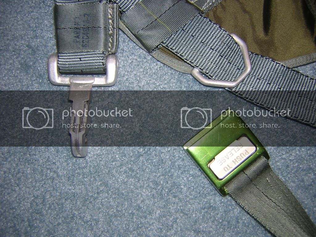

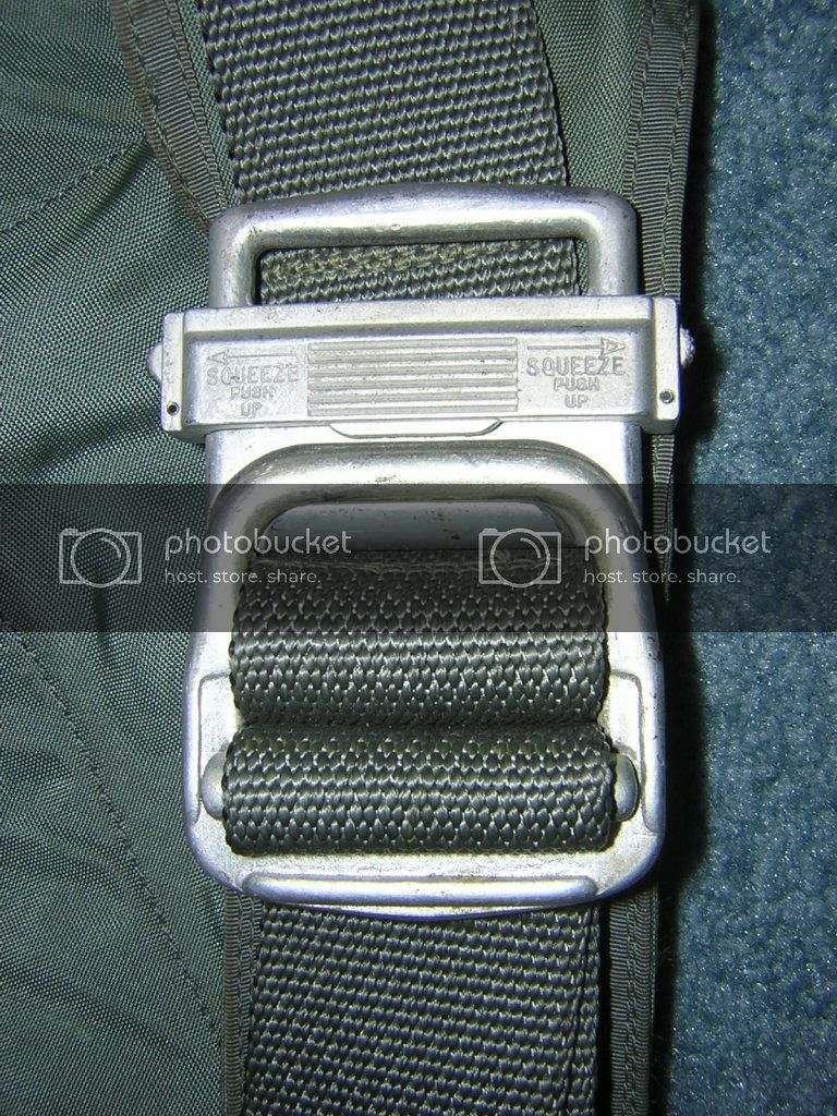

Those aren't RJE fittings on the waists of the quick fit harnesses. Those are just "accessory rings" as used on all USAF harnesses. They are for those green colored push button release fittings used on AF survival kits. If you have seen the later adjustable J5D seat harnesses, the Army used the accessory rings to pass the free floating lap belt through.
The diagrams shown in the 1962 -10 only show the harnesses in general, doesn't show the vertical straps, but you can see the adjustment fittings are there, as well as the lower RJE fittings aren't shown on the MA-2 to simplify the drawing. If you ever see the full body suit MA-2s, the lower fittings hide inside the suit at times. They apparently wanted De-cluttered basic diagrams of the harnesses. All MA-2s have that lower lap-belt.
Here are some pics I took of both the accessory rings, and RJEs and how the RJE cannot function with the accessory ring:
Accessory ring with the appropriate connector buckle:
Accessory ring compared the RJE:
RJE male and felmales:
