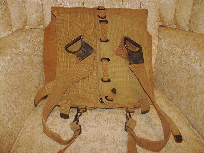

All of the 1912 Ration bags I have seen having the red cross on them were altered by having the had the metal D rings removed from the back on the straps and the straps sewn directly to the packs, Ray

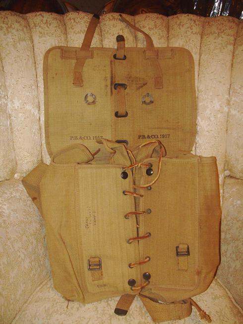

#24
I picked this up this weekend with several items from a yard sale.This pack has medic insignia on the front flaps.
I have never seen one like this can anyone tell me what is was used for or what it is exactly.Thanks for any help.
Shaun
