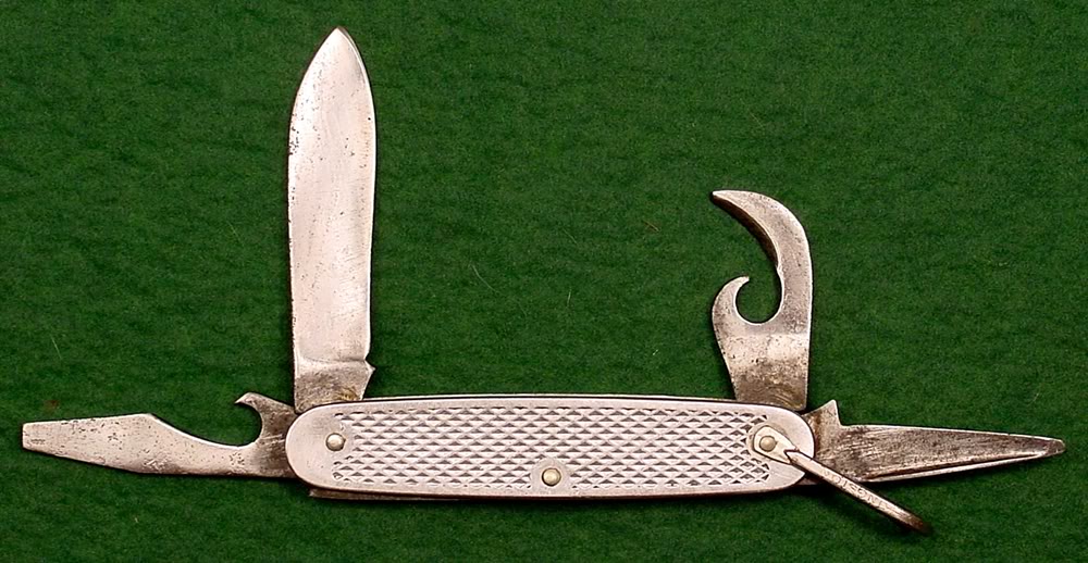

Quick background. In 1944 a project was started to develop a single pocketknife that would replace several knives to simplify purchase, inventory and issue. Although it did not succeed in the original goal, it did result in a knife that became the predecessor of the current stainless MIL-K 818.
1944-45 production of the KNIFE, POCKET, GENERAL PURPOSE had stainless steel handles, carbon steel blades, and brass liners. Production was first for the Marines, and then the Army. KINGSTON made ones for both (Marine ones are marked U.S.MARINE CORPS). Kingston was a trade name used by a combination of Ulster Knife and Imperial Knife. Stevenson of Buffalo NY (as far as I know) made them only for the Army.
First production was for the Marines, and had the cap lifter/screwdriver blade on the same end as the main blade, but production was later changed to have it on the other end as is currently used on the MIL-K 818.
There are a number of maker marking variations on the bails, ranging from none (apparently Kingston) to Kingston and Stevenson and Stevenson-45.
I recently acquired this specimen which has a marking set that I have not seen before. The bail is marked KINGSTON on one side, and U.S. 45 on the other. The can opener is marked CAN OPENER and the main blade is marked USA. An interesting version that I had not seen before.

Yes, some (apparently made by Kingston) are found with no markings whatsoever. There are both Army and Marine versions with no maker mark on the bail.

I have two Marine versions; one marked "Can Opener - Patent Pend.", while the second one just says "Can Opener."
Is the one marked "Patent Pend." the earlier one? Any idea of the years of production of the two varieties?
Thank you.
#9
Because I just happen to have my stainless steel knives out, I thought I would answer this question. My 1944 knives have "Pat Pend" under "Can Opener" (both Army and USMC) and my 1945 knives either have no markings (one Army, one USMC) or just "Can Opener" (the Army one with "Stevenson 45" on the bail).

Assuming it is a US issue with US on the side, look for a pin on the screw driver to help open the blade. They transitioned the pin out in 1973/1974 so if there is a pin, then 1966, if no pin, then 1986. Not sure who made it as the ones I've got or handled had Camillus, Imperial, or Shrade over the date. I've never seen one with just a "Q."

Made by Queen in 1986. Queen only made them in 1986. You can find them in two versions. One has the Q inverted.
