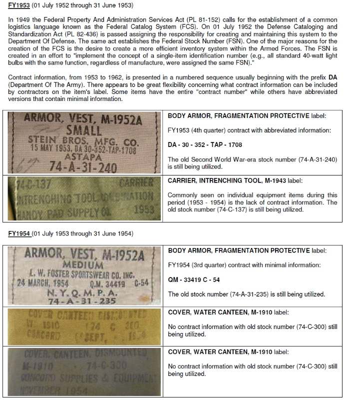

sgtmonroe Posted December 20, 2010 Share #7 Posted December 20, 2010 I quickly generated a "visual" listing of the common contract types and stock numbers from 1953 - 1993. These are common variations and do not take into account test/trial items, project contracts, DPSC procurements, etc. There are always exceptions to the rules. The date preceeding each section is the Fiscal Year. I tried to utilize common items (at least one clothing item such as a field jacket and at least one equipment item such as a canteen cover for each year) but, considering I compiled this in a few days, I was not able to find similar items for all Fiscal Years. Link to comment Share on other sites More sharing options...
The Meatcan Posted December 20, 2010 Share #8 Posted December 20, 2010 that's a great post sgtmonroe! thanks for taking the time and effort to do that up. I suggest that something this useful, along with Forum Support's markings cheatsheet, be pinned as a handy reference thread, if it hasn't been already. nice work! :thumbsup: Terry Link to comment Share on other sites More sharing options...
316th FS 324th FG Posted December 21, 2010 Share #9 Posted December 21, 2010 Def agree with Terry, kudos sgtmonroe! Very helpful Link to comment Share on other sites More sharing options...

sgtmonroe Posted October 9, 2011 Share #14 Posted October 9, 2011 For those that saved the information I prepared (and presented in the thread) - I have resized them so they are a little larger and easier to read. Further, I have updated the last section. I have added information concerning the change of the fiscal year in 1976. If anyone is interested, I have all the information in pdf format, which makes it easier to read. Just PM me. Link to comment Share on other sites More sharing options...
