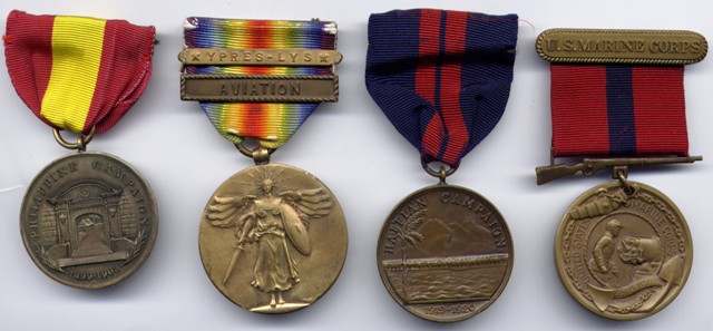

bobgee Posted July 24, 2008 #33 Posted July 24, 2008 In his post today with the pics of the named WWI Victory Medal to USMC Capt. Robert Lytle, "Belleauwood" posed the question of whether the WWI Army 'Ypres-Lys' battle clasps found on WWI Victory medals in combination with 'Aviation' clasps to WWI Marines are authorized or self-awarded. I have a group in my collection which answers this question However since the group itself has a story beyond the 'Ypres-Lys' clasp question I thought I'd post it here in a new thread. Thank you Dennis for 'calling the question!" This Marine & former U.S. Army cavalry trooper is Emil F. Johnson. Born in Copenhagen, Denmark September 19, 1880, he enlisted in the 14th Cavalry, U.S. Army on November 1, 1901; discharged October 28, 1904, Character: “Very Good”. (1st Enlistment) He re-enlisted November 12, 1904 in the 15th Cavalry; discharged November 12, 1907, Character “Good”. (2nd Enlistment) He enlisted in the Marine Corps for his first hitch on November 22, 1907 and was discharged November 21, 1911, Character: “Excellent”. (3rd Enlistment) There is no indication that he was recommended for a Good Conduct Medal. He did receive USMC Philippine Campaign #257, confirmed in his records with several entries and the medal receipt dated December 15, 1908. (The ribbon on this medal was shot and has been replaced.) His qualifying service for this USMC Philippine Campaign was as an Army Pvt, 14th U.S. Cavalry, Feb 1902 - Aug 1904. service. He again re-enlisted in the 15th Cavalry, U.S. Army on November 30, 1911 serving 1-year and being discharged November 26, 1912, having served less than 1 year. (4th Enlistment) He re-enlisted into the USMC again on December 17, 1912 and was discharged December 16, 1916, Character: “Excellent”. (5th Enlistment) He was awarded his first USMC GCM No. 6747 for his 5th Enlistment. He again re-enlisted into the USMC on January 17, 1917. It was during this enlistment that he entered Marine Corps Aviation. He served in France with “B” Squadron, First Marine Aviation Force, exact duties unknown, from July 30, 1918 until December 6, 1918 when he returned to the U.S. He arrived with his aviation squadron at Port-au-Prince, Haiti on July 1, 1919. He died there of “acute alcohol poisoning on October 30, 1919“. A review of his records indicate he had problems with alcohol. His remains and personal effects were returned to the U.S. the following day aboard the U.S.S. Gulfport. Later, his wife received a WW I Victory Medal with the Aviation Clasp and the Ypres-Lys Clasp in January 1921 as confirmed by letter in his records. So it is without a doubt an 'official' award. This is a rare Victory medal combination for USMC recipients and is only found to members of this Aviation unit, the First Marine Aviation Force. In the late Col. Al Gleim's "The Medal Letters" he discusses this unusual combination in detail on Page 94, Sect. D42. Mrs. Johnson also later received USMC 1919-1920 Haitian Campaign #2579 for which he is indicated as eligible in Smith’s compilation for that medal. This is a most unusual medal group to a Marine who unfortunately “died of the drink”. He was a Private, age 36, at the time of his death. Here is his medal group. hope you enjoy! Semper Fi.....Bobgee

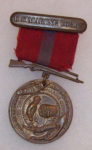

Brig Posted January 4, 2009 #34 Posted January 4, 2009 Well, I know the ribbon is a bit worn and frayed, but it'll be well-loved. This is the second rim numbered GC in my collection of 3 rim numbereds that I acquired cheaply (20 bucks or less) from eBay auctions that neglected to mention the rim number.

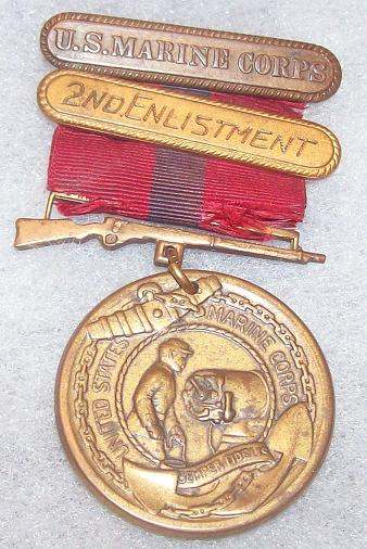

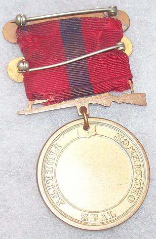

Brig Posted February 14, 2009 #35 Posted February 14, 2009 I've been looking for a USMC Good Cookie with a bar on it for awhile now, but they always seem to go for big bucks. Managed to snatch this one on eBay. Well worn with the ribbon tattering where the rifle suspension hangs, a common problem on Marine Good Conduct medals as any of you who collect them will know. The edges on the medal itself are a bit more round than many examples out there. The reverse of the bar is engraved by hand 'No 95585' and '1934-1938'. The medal itself, however, is unnamed and unnumbered. Why do you suppose? Was it a replacement medal the individual purchased? Or perhaps in the 30s they no longer engraved the medals for 2nd, 3rd, 4th, etc enlistments? Any ideas from you older medal collectors? thanks a well worn, but nice piece welcomed into my USMC Good Conduct Medal Collection. Lucky number 8 (10 if you count the minis).

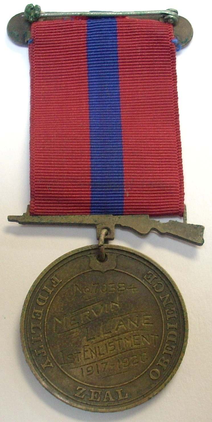

bobgee Posted February 14, 2009 #37 Posted February 14, 2009 I've been looking for a USMC Good Cookie with a bar on it for awhile now, but they always seem to go for big bucks. Managed to snatch this one on eBay. Well worn with the ribbon tattering where the rifle suspension hangs, a common problem on Marine Good Conduct medals as any of you who collect them will know. The edges on the medal itself are a bit more round than many examples out there. The reverse of the bar is engraved by hand 'No 95585' and '1934-1938'. The medal itself, however, is unnamed and unnumbered. Why do you suppose? Was it a replacement medal the individual purchased? Or perhaps in the 30s they no longer engraved the medals for 2nd, 3rd, 4th, etc enlistments? Any ideas from you older medal collectors? thanks a well worn, but nice piece welcomed into my USMC Good Conduct Medal Collection. Lucky number 8 (10 if you count the minis). Tim - This piece is likely a replacement medal with re-enlistment bar added. Or, an un-named specimen to which someone added a loose, issued bar. No. 95585's original 1st Enlistment Named medal was awarded in 1934. I have Medal No. 95597 in my collection. "No. 95597 WILLIAM V. LYNES - 1st Enlistment 1930 - 1934" (Harris Type VII)(S) (B. 01/02/1909, D. 11/22/1974 MSgt )" Semper Fi....Bob
Brig Posted February 14, 2009 #38 Posted February 14, 2009 the wear of the ribbon on the edges around the bar indicate that this bar has been on there for quite some time, looks like decades, so I'm inclined to think he replaced his original medal. Is there a reference to determine the 'types' of this medal? I haven't seen one yet Thanks for the info, Bob.
bobgee Posted February 14, 2009 #39 Posted February 14, 2009 the wear of the ribbon on the edges around the bar indicate that this bar has been on there for quite some time, looks like decades, so I'm inclined to think he replaced his original medal. Is there a reference to determine the 'types' of this medal? I haven't seen one yet Thanks for the info, Bob. George Harris, GBHMedals on EBay, many years ago published an article which "typed" the styles of engraving found on USMC GCMs. Many Medal Collectors are familiar with the types and often use them in their descriptions. The medals themselves have almost no differences in the planchet, the most common difference being the chocolate brown coloring on the first issues in 1896, about 200 pieces. The first and second types also had two different types of open catches, which often broke, up until about 1911/12. Then the catch was replaced with a lock & roller type which continued until the bar was eliminated. Scott Smith of San Diego has recently published a GCM refererence which incorporates the "Harris Engraving Types" Search on Google. Semper Fi....Bob
