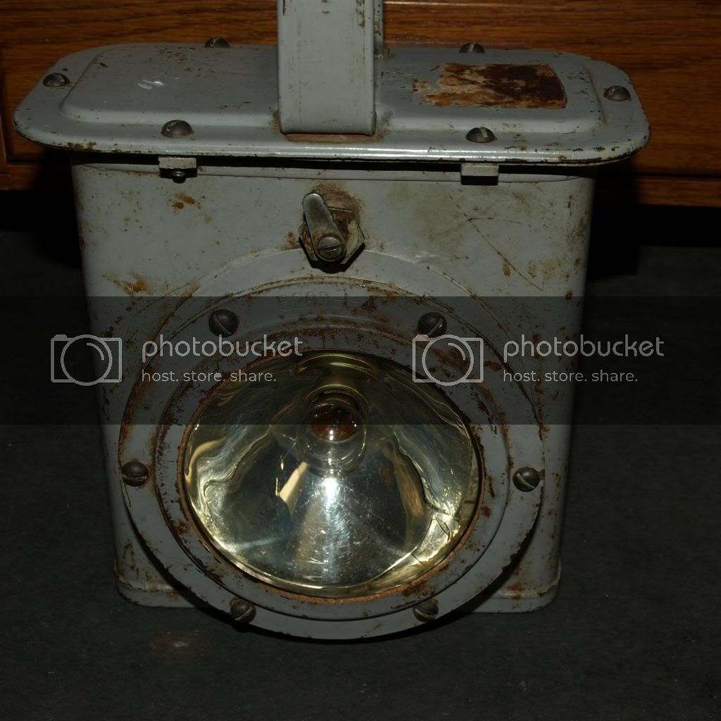

River Rat 1 Posted July 3, 2012 #26 Posted July 3, 2012 It's the metal WW2 battle lantern that used used the no6. dry cell the chinese make the only one and I read they leak so the D Cell converter one's look like the way to go plus D cell's are easy to find and cheaper to replace than the cheap chinese copy of the dry cell no.6. http://www.prc68.com/I/No6.shtml Bakelite has to be carved, not molded.
River Rat 1 Posted July 3, 2012 #27 Posted July 3, 2012 Here is a link that told me what battery goes in to a WWII era battle lantern believe this a flash light forum. http://www.candlepowerforums.com/vb/showth...-Battle-Lantern

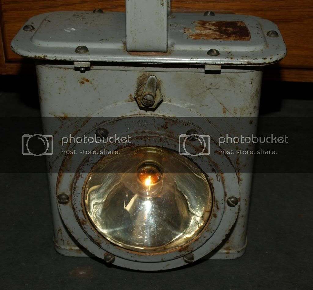

River Rat 1 Posted July 11, 2012 #28 Posted July 11, 2012 I got the drycell adapter today they take one D cell battery per adapter so a total of two D cells battery's was needed to get the battle lantern to work.Had to replace two of the connectors to the wire's and she works. What's the point of having it if it's not in operating condition.Had two replacement bulbs but the original bulb still works.Think I would devalue it if I clean up the case and repaint it haze gray.
