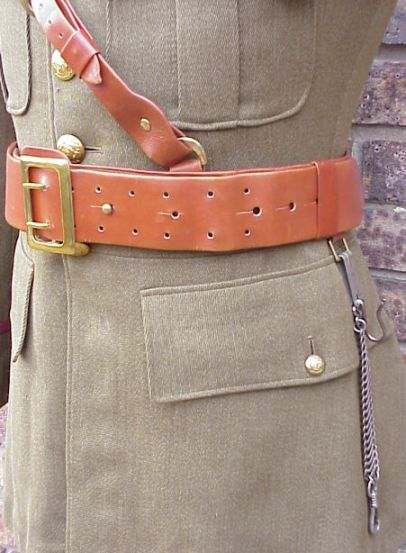

The most well known belt and hanger system for US Army Officers during the 20th Century has been the Sam Browne belt and chain sword hanger. I know these were not authorized to be worn in the US homeland during WWI but could be worn in Europe by the AEF until circa 1919. They were widely worn after the late 1920s. When was the Same Browne authorized for the AEF and later in the homeland? When was the chain hanger authorized?

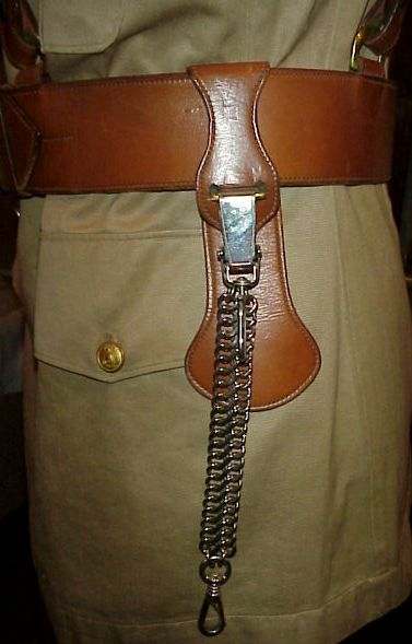

There are variations of this sword hanger and the belt attachment method. Some were attached directly to a D ring on the belt as above and some were attached with a removable leather frog.
I think these are mostly manufacturer variations but is there an introduction date that these belts and chains were authorized for all Army Officers?

The chain was authorized in Ordnance Memorandum No. 1715, dated 5 October 1914.
The Officer's Belt
(PLATE IX)
....The leather saber attachment formerly used is replaced by a chain saber attachment, as shown in Plate IX. This chain saber attachment is of 27 percent nickel steel throughout and is finished bright.
The crossed straps shown in your last image were authorized for field use in General Order 132, dated 31 December 1902.

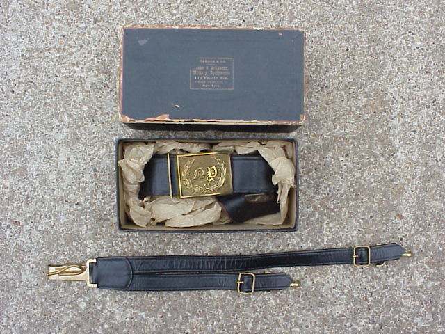

Here is a boxed set of accouterments for a NY State Militia Lieutenant which consist of a black belt and black leather hangers. I can easily understand the various state militias being out of step with the US Army regulations since they tended to march to their own drummer.

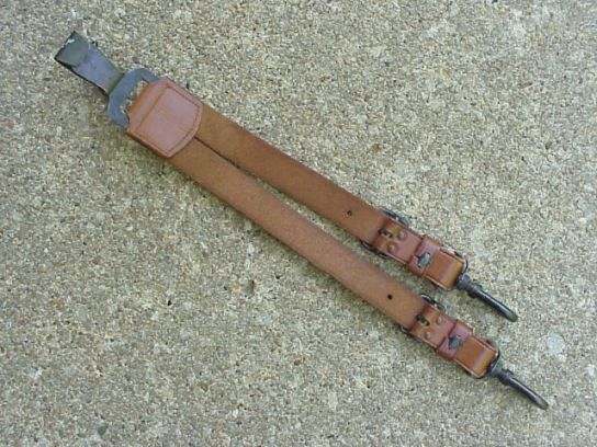

Here is a set of roughly the same style of leather hangers in russet leather instead of black. Notice that the brass fittings are bronzed and not finished bright.
And, a shot of the back of the hangers showing the snap at the top and the construction of the leather slings.

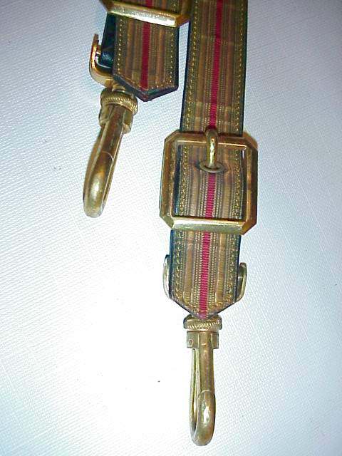

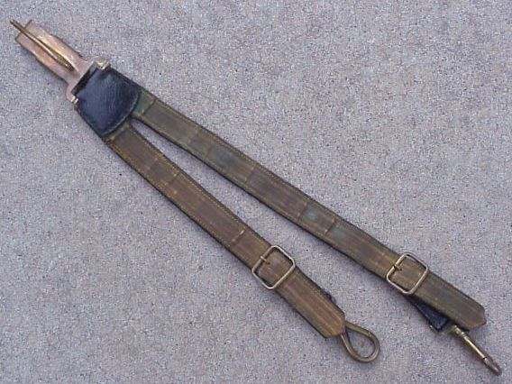

Here are a couple of more hangers for the model 1902 Army Officer Sabre. These are bullion full dress hangers for a Lieutenant or Captain of Artillery.
Closeup view showing the red branch stripe in the bullion facing and the gilt buckles and hooks on the slings.

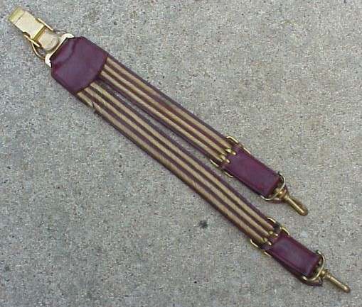

Another hanger for higher grade S&F officers. These hangers do not have branch piping in the gold bullion facings. These bullion slings follow the same style as the bullion belts for these ranks.

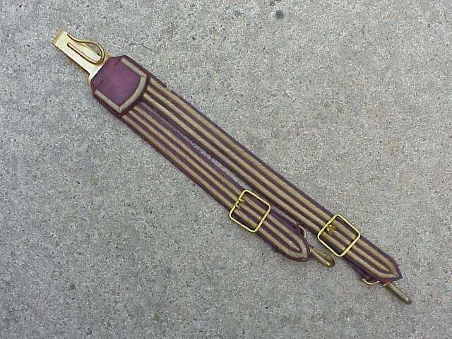

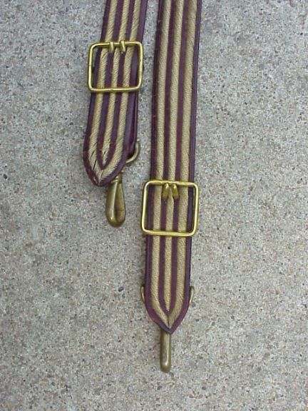

General Officer sword hangers also follow the style of the GO belt having red (Russia) leather slings with three broad bullion wire stripes.

I also noticed that while I mentioned the General Officer sword hangers I failed to post a photo of them. Here is a photo of the General Officer hangers mentioned in the post above.
In the regulations of the era, the belt for general officers is described as 'red Russia leather'. For BG's, a buff sash was worn, I believe with a different belt underneath -- typically web or fabric but with provision for attaching a saber hanger. MGs, LTGs and GENs wore their sashes over the shoulder and the red Russia leather belt around the waist.
This cloth belt typically had a buckle and was also worn under the dress coat, the one with shoulder straps and mohair trim. If the sword was worn with this coat, the slings came out through the longer slit on the left side of the coat.
I will see if I can find my example later on.
G
Thank you gents!
The General Officer hangers were made by Ridabock and are so marked on the top fitting. Notice the buckle is manufactured with two prongs so as not to disturb the bullion stripes. An elegant solution IMHO. I would love to see your example Gil.

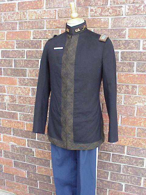

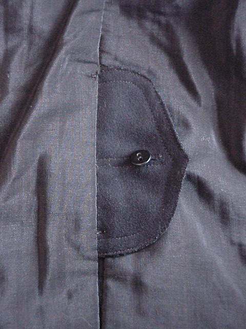

BTW, I have a Model 1895 blue officer coat that has a buttoned flap for the sword hangers in the left waist seam. This is a variation of wearing the hangers on an underbelt that allows them to be worn through the long slit on the left side of the coat as you describe. The coat is a WWI period named coat BTW.

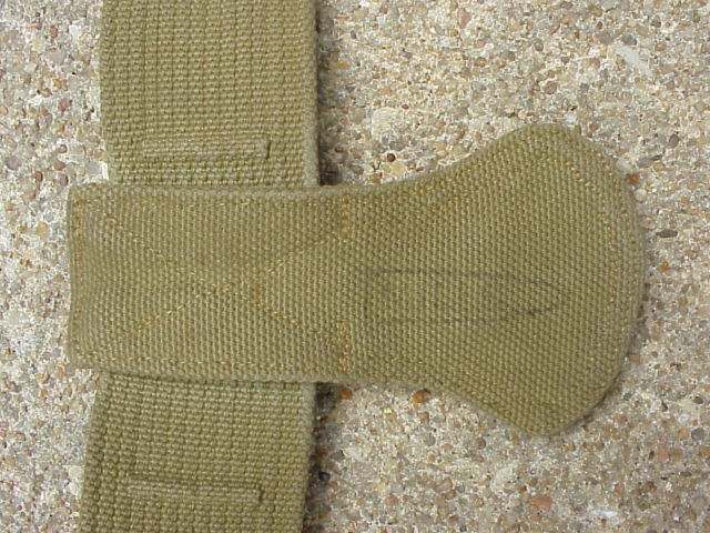

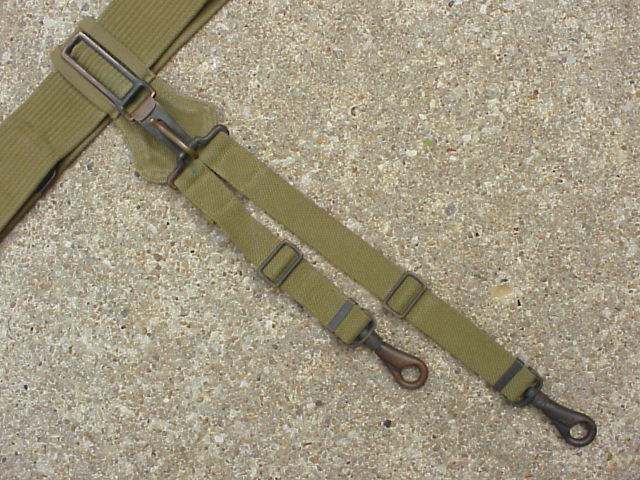

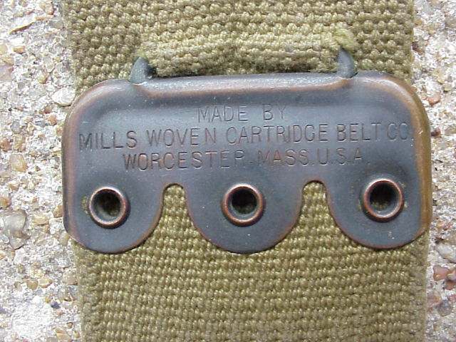

I thought I would add the Model 1910 web garrison belt and hangers to this discussion of sword belts and hangers. The 1910 Officer’s Garrison Belt (olive drab & khaki webbing) was made by Mills and issued to Infantry Officers to carry the Model 1902 Army Officer Saber. Cavalry Officers continued to wear the leather belts and hangers.
